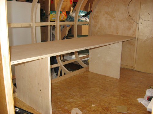

I do not know if you plan to do this but this is what I would do. Probably giving more basic direction and if you have a plan feel free to ignore me(I am used to it - wife does it all the time) :lol:
1. drill pocket holes in counter - 1 every 6"-8" is plenty
2. clamp a wide board against the side of your trailer that will support the counter at the height you want the counter on each side. Board should go from floor to counter height
3. Screw counter to sides and remove boards
One of the nice things about doing it this way is that now you have the height of your cabinets already measured(you can measure your support pieces and cut the sides of your under-counter cabnets and your counter can act as the top of your cabinets.
Rick

Thanks Diver guy. I bought the single Kreg so the instructions were limited and are who knows where they are. I just love it :thumbsup:
Sounds like good advice Rick. Thank you. I guess I will stack the rest of the tower on the counter and call it good. Glue the daylights out of it. :R
Postby Miriam C. » Sat Apr 21, 2007 6:56 pm

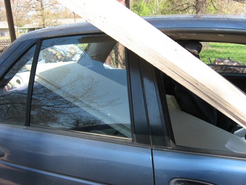

:applause: Well it is pulled in for now. :worship: I guess I can quit backing up for a day or so. This is the beginning of the new (again) galley. My bones hurt so I quit for TD puter time.
Guess how I got 2 sheets of 3/4 birch home 8)

Ya just gotta get that nice young man at Lowes to cut it for ya on the biggy saw. 8) Then ya gotta load it just right, and ignore the shaking heads. :lol: 8) :lol: ;)
The two sheets outside are 10"w and 8' long. The long ones inside are really 18"w and 74 1/2" long. :thumbsup: I am really gonna miss this car when it really dies.
