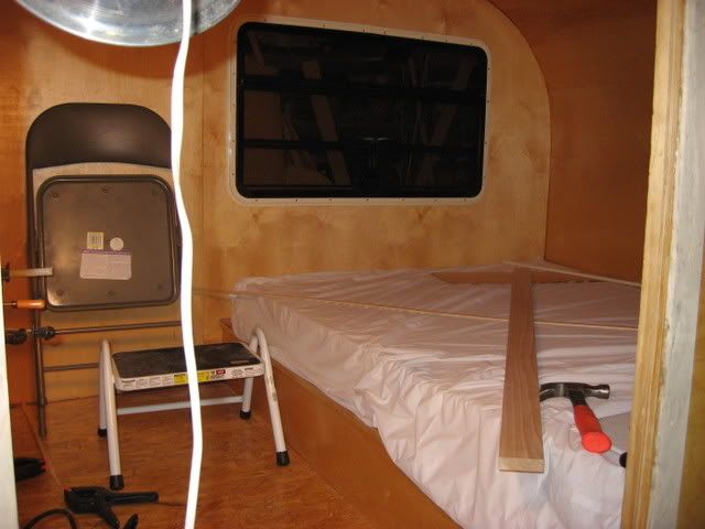

Postby Tim & Lori » Fri Jun 22, 2007 8:33 pm
One thing to keep in mind is the availability of bed sheets that'll fit. I think you'll find most camper sheets, designed for 4" thick mattresses are 58 or so" wide and 75" long. Before you lay out your interior, figure your bed size, and before you figure your bed size, make sure you can get sheets. We found the most available for a 4" thick camper size mattress was 58" wide X 75" long. This fit nice in a 5' wide cabin with 3/4" thick walls. Just a heads up so you don't waste any precious space.
