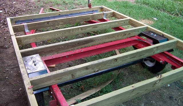

Postby bobhenry » Fri Nov 16, 2007 8:13 am
4x8 HF axle and tongue . Frame was trashed when the previous owner tried to load a 1200 # bolder on it. Chubby is 63" inside and has a queen size bed in it. After this shot I put 2 layers of 3/4 " foam to bring the floor level with the steel fenders which I left intact for protection . I then covered the foam with a layer of 7/16 osb over the fenders.

Postby bobhenry » Fri Nov 16, 2007 9:26 am
They are the HF 12" that came on my 40 x 48 motorcycle tear. I put the 8" off of this frame on the motorcycle tear to drop the tow height and put it's 12" on Chubby. I found out it is all but impossible to change a tire if the need arises on mine. Make sure you leave enough room to remove and reinstall the tires.
