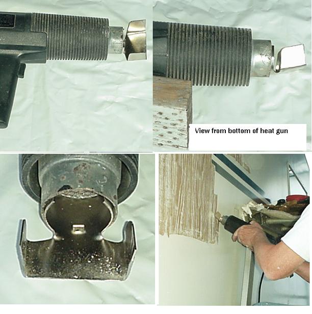

What’s the answer? I decided heat was the best way, but there had to be a better method. I went to Home Depot to look for ideas. I couldn’t find an electric tool to remove paint with heat, but did spot a package of Milwaukee heat gun accessories. In it was a flat blade “glass protector nozzle”. That got me to thinking. I bought it and went home.
The nozzle fits a Milwaukee gun, and mine is a B&D. It woudn’t fit around my heat gun nozzle, but it did fit inside it. I decided to make a heated scraper. I needed about a 2” width. I could have cut off the ends of the blade, but instead, I bent them up to keep the heat from spreading out. I used a grinder to cut away some of the bent up ends to keep them off the wood and ground a beveled edge across the front of the scraper part. I slipped it into the gun and bent it up slightly. It’s positioned so that I hold the heat gun with the handle out to my right.
I turn on the heat gun, lock it in the on position, give it about 15 seconds to heat the scraper blade. Holding the handle out to the side in my right hand and the top of the barrel in my left, I direct the heat onto the paint until it starts to bubble. Then, I press the scraper down onto the paint and push forward (or up if on a wall). The heat flows onto the paint, but also heats the blade and I think that the heated blade does as much as the heat flow to soften the paint. I peel off a strip from 1” to 1 ½” wide and it takes off about an inch of length of paint per second. That’s slow, but steady and using both hands to control the scraper pressure works better than one. I think this is the way I’ll take off most of the remainder of the paint.

I found a problem with my home-made stripping tool. The metal is not tempered and I have a hard time keeping it flat and keeping the beveled edge in shape. I went back to the heat gun and 2" putty knife (with the edge beveled) and found that with practice, It was faster than using the tool that I made.
