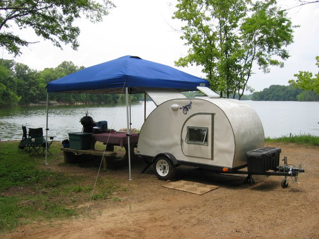

:lol: Not very old are you? 8) The sun will heat the side and it will stretch out like a bubble. ;)
This is covered in Polymax and is beautiful till the sun got hot.
This is SidnSide's build site. Great information in it.
http://picasaweb.google.com/tdcampers/T ... 0511To0606
