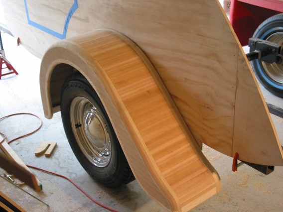

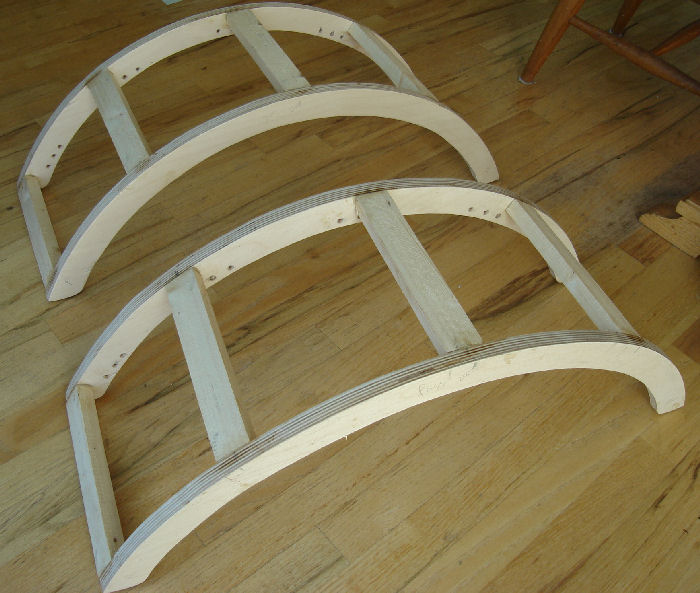

Plywood fenders
Postby pete.wilson » Fri Feb 22, 2008 10:18 pm
Hey
I came across a picture of someones trailer fender where he used plywood which was high in numbers of layers: http://tnttt.com/album_ ... c_id=15795
Where can one purchase this type of plywood since most house supply's (Lowes or Home Depot) won't carry this quality of plywood; usually its 3 to 5 layers for normal plywood or 5 to 8 layers for birch/oak veneer plywood depending on thickness of course?
P.S. I remember working on the mockup of the HondaJet when I lived in NC and they had 1/4 ply which was something like 8ply, it was awesome plywood. Made great radio control airplane firewalls!

Postby madjack » Sat Feb 23, 2008 12:27 am
Pete, I buy thru a cabinet shop and get 13ply 3/4" and 11ply 1/2".......................... 8)

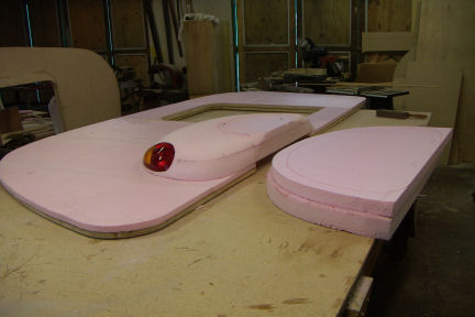

Postby Gaston » Wed Feb 27, 2008 7:09 pm
if you don't mind the work of building them they can be done for about 100.00in materials resin, glass and mat and a sheet of pink foam
and I think mine are sure "one off"" and diffrent! :D

Postby Nitetimes » Thu Feb 28, 2008 1:15 am
Gaston wrote:if you don't mind the work of building them they can be done for about 100.00in materials resin, glass and mat and a sheet of pink foam
But can you really call them fenders???? 8) :lol: :lol: I think that's really a wall with a big bump ain't it?? :lol: :lol: Actually that's almost too cool to be legal!! :thumbsup: :thumbsup:

Postby doug hodder » Thu Feb 28, 2008 2:03 am
John....you forgot the paint! I'm pretty sure it's not just a HD latex! One off, yeah...different...you betcha...wonderful/ stunning....for sure!!!! Doug
