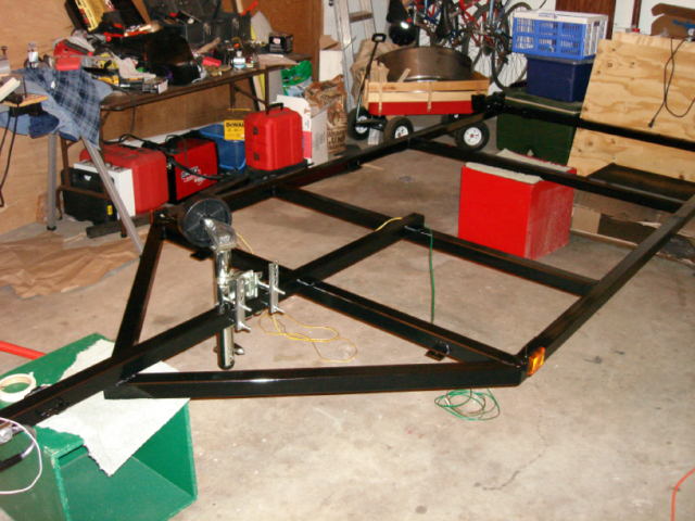

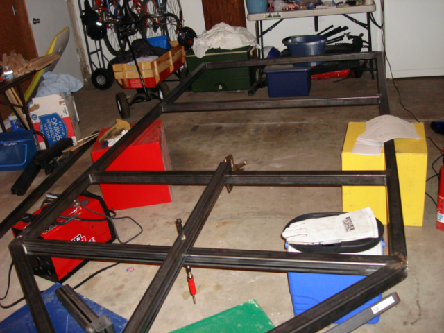

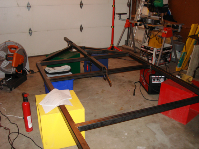

Welding is great fun to learn - spent a 1/2 day practicing on scrap and then dove into the frame. The good thing about welding is that it is easy to tell when you have done a crappy weld - the bad thing is that I'm not aware of a good way to test if the weld that you think is good to prove that it is good (at least with affordable home equipment). I ended up grinding down and re-welding anything I had any doubts about. Here are some pics of the frame:

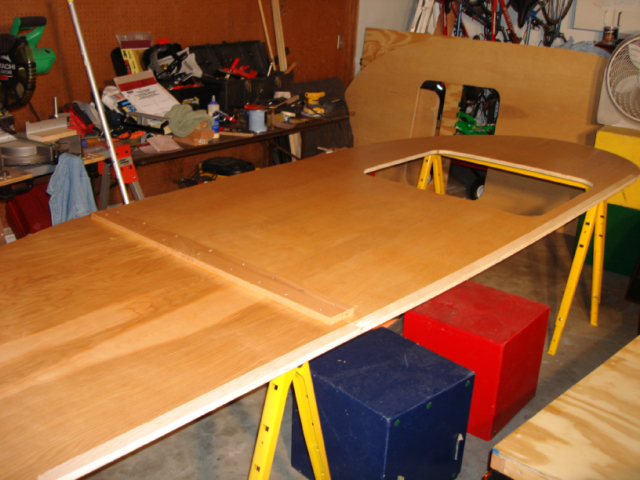

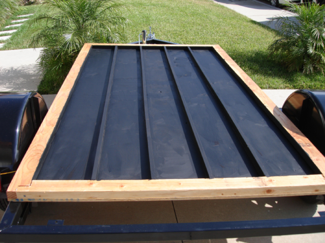

I tried to do a simple floor - this is 1/2 inch 5 ply with a flat 2x4 outside pine frame and 1x2 poplar strips. With all the support of the trailer frame this seems to provide a very sturdy base - heavier than I would like though.

:applause: :thumbsup: Your welds look great from here. 2x4 might be heavy since you have 1/2" floor too. Depends on what you want your weight to end up. ;)

I can see patience is key for this - everything takes time to find, order, learn how to use and apply. Taken the frame as far as I can without an axle (on order). The idea is to make it possible to detach the frame from the living quarters so I welded on a series of tabs to the frame to bolt through the 2x4 flat frame. I'm thinking the sides will attach to the wood frame and not overlap onto the frame.

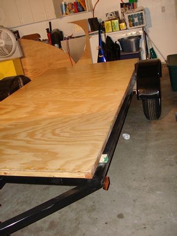

Well it's been awhile since an update. Recently got the axle welded on and mucked around with the fenders for far too long. I fabricated the fender back splash from thin gauge steel sheet and welded some angle iron together to get it the right distance for the wheel. End result is mobility - trip around the block didn't show major problems :D :D
I used the rot doctor CPES on the bottom and sides of the deck and covered the bottom with home depot roof tar. Probably overkill ... I left the sides of the bottom with only the CPES as I'm planning to fiberglass all the joint edges. I figure it can double as a boat... Image
Flipped the deck right side up and put spar urethane on the floor.
