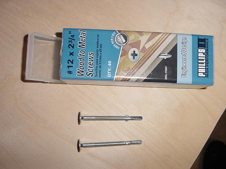

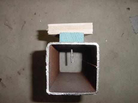

Hey, back on topic, I found some screws at Lowes that should work just fine for attaching the floor to a square tube frame. I did a test set up using scrap from my floor and floor framing into a left over section of tongue steel. Penetration is adequate and the screw grips the steel VERY tightly. The wood does not want to move or pivot around the screw at all. They were about $7.00 for a box of 100. I drilled a pilot hle in the steel as the screws will not cut through it by themselves.
So here's an off the shelf readily available alternative.

Those guys look good but I can't tell how big they are. I'm using a #8 wood screw on my wood to wood material and that's pretty small. If a #12 is just 30% thicker, I might get something thicker.
The box does show them being used for what looks like wood deck to metal frame but it doesn't show what size the final deck and metal base is . That can make a difference.
I'd want something at least 3/8 inch thick going through the metal to attach the deck so the screws/bolts don't snap off under any pressure.

Do you know how thick, in inches, a size #12 bolt is? I went out to the garage and looked at what I had that was labeled. A #8 was about 1/8"; a #6 was slightly less than 1/8". Following that information, I suspect a #12 would be less than even 1/4" thick and might be "iffy" as far as strength goes.
Perhaps Mr Shoeman can measure the thickness of his bolts to see that they are thick enough to stand up to any possible stress? :thumbsup:

I just ran out to the garage to measure one.. they are 3/16" diam. at the root of the thread. They caught my eye in the store because they looked similar for the most part to the "deck screws" that are mentioned often as being used for this application.
JuneauDave uses those. Dave, if you're listening, what are the specs on those things?
As he did, I thought to space them every 12" to 16" around the perimeter. Many smaller fasteners or fewer larger ones is how it usually works in regards to strength of a joint I think.

Thanks Dave. I just found them at Redneck. In my case I don't think the difference between the 1/4" you used and the 3/16" I found is enough to worry about since I'm going to use plenty of them. They are listed as High Strength steel, whatever that is who knows, so that is a plus too.
Maybe I'll do some destructive testing over the weekend just to set my mind at ease. :thumbsup:
