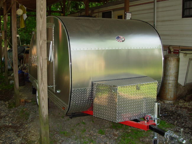

Here's what mine looks like. There's another 'joint' exactly the same (except faces the other direction ;) ) just in front of the fantastic vent
