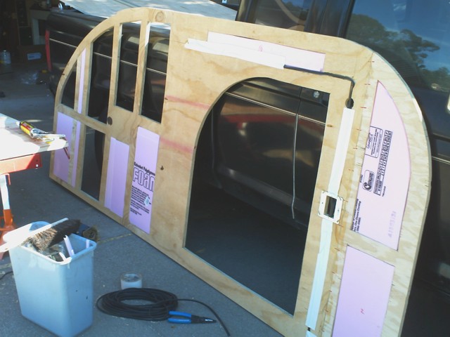

Postby bledsoe3 » Sat Aug 23, 2008 11:48 am
Insulating the side walls is not that much more work.
Plus, if you do it now, you won't be sorry later that you didn't.
bledsoe3
Posts: 3694
Images: 112
Location: Oregon, Portland
Postby Mauleskinner » Sat Aug 23, 2008 7:56 pm
bledsoe3 wrote:Insulating the side walls is not that much more work.
Ditto...mine's going to have insulated walls. Not that much more expense or effort, and will end up lighter and more rigid.

Postby satch » Sat Aug 23, 2008 10:42 pm
Same here, since I went the "sandwich" route, it made the walls lighter too.
