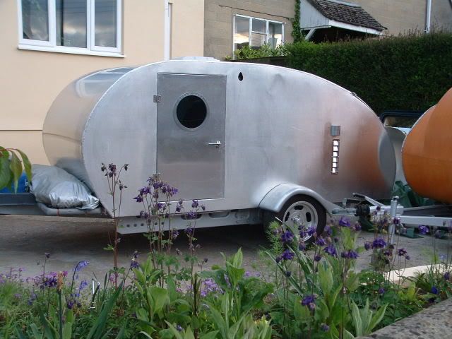

Postby jackdaw » Fri Oct 03, 2008 8:27 am
I think the fiberglass fender look great, but the cost + shipping made them out of my reach over here in the UK.
I made my own from insulation , and then fiber-glassed them. They needed filling and sanding several times before I was happy with them. It was a fair bit of work, but and very satisfying well worth the effort.
As we don't have many teardrops over here so I just made them the shape I thought looked right :thumbsup:
I haven't made anthing out of fiberglass before , but wouldn't hesitate on making my next pair the same way for build 2.
From this;
x2
With a thiner piece added, held together with disposable chopsticks,
Shaped with course sandpaper;
Add two layers of chopped stranded fiberglass mat and resin;
1 days worth of filling and sanding;
Remove insulation;
Sprayed silver and fitted;
I think they probably cost somewhere around £20 in materials. :thumbsup: :thumbsup:
Sometimes you don't know what you can do until you give it a go.
Cheers Dave

Postby Sam I am » Fri Oct 03, 2008 8:56 pm
Nice job on the fenders, Dave! They look good on the tear. Looks like you did a very good job building the tear, too!
