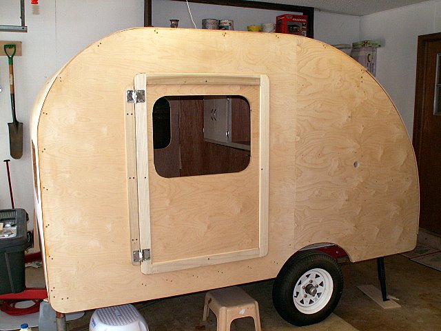

Postby 48Rob » Tue Oct 14, 2008 5:53 pm
Von,
4' High is common, or standard.
Some build with 5' or higher walls, though they tend to be more of a stand up style, than a teardrop style.
4' High is generally chosen because of availability of material, and cost.
Though there are no rules set in stone as these are home built trailers and as such can be configured to suit personal taste, symmetry is important.
A good "rule" is 4' wide x 8' long x 4' tall.
5' wide x 8' long x 4' tall also looks pretty good.
Generally, if you build longer, the height needs to increase proportionately, or it just looks "off".
Mine is a close replica of the largest commercially available teardrop that was made.
It is 5'-2" tall x 7' wide x 12'-3" long...a monster!
(the original was slightly smaller).
But! The proportions, the symmetry, all work together to give it smooth flowing lines.
Build it how YOU like it, but pay attention to keeping it mainstream if you intend to sell it someday...strange, and odd, are okay while you own them, but can be tough to pass on when its time to sell...
Rob
