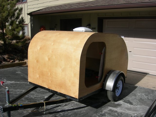

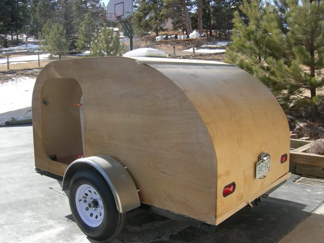

Postby EPGregg » Thu Feb 12, 2009 10:08 pm
Thanks to everyone for all the advice so far. I went with Poly Construction Adhesive for the 2nd roof layer. Time will tell if that was the right decision, but it was pretty easy to work with.
Ordered door "Parts" from Grant @ Lil'Bear today. The build continues.

Postby xrover » Fri Feb 13, 2009 5:31 pm
I really like the recessed rear lights. Very nice.

Postby Lou Park » Fri Feb 13, 2009 9:18 pm
I'm worried about the placement of your wheels.
How far from the back are they?
Lou
Lou Park
Posts: 433
Location: Northen Illinois
Postby EPGregg » Fri Feb 13, 2009 9:48 pm
The frame is 5' X8' and the axel is about 42 inches from the rear (about 6 inches from center). It's a torsion axel.
The camera angle makes it look a lot more forward than it is.
I will have a spare tire mounted underneath (roughly 2 feet from the front of the frame) and a tongue box well forward of center as well.
Gregg
