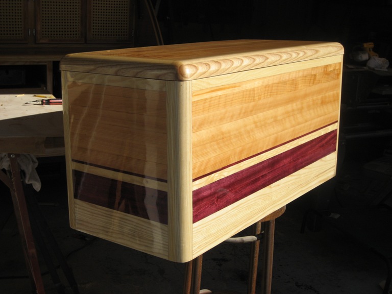

I used the RAKA 4 oz. (actually, I think it was 3.8 oz at the time I purchased it) on the roof and tongue box, and skipped the cloth on the sides and just coated with epoxy. I'm a little skeptical about the auto clear coat for UV and longevity as compared to spar, but I'm using it anyway as an excuse to learn how to spray paint....
I got to say...I'm impressed with the quality of finish now that I'm starting to get the hang of it. I shot the tongue box last weekend. The box has 4 oz RAKA cloth w/ MAS epoxy, shot with Dupont Chromaclear, wet sanded to 1500, then finally buffed out with 3M 6062 Perfect-it compound, 3M 6064 swirl mark remover, 3M 6064 glaze and finally, a coat of Bode wax.
