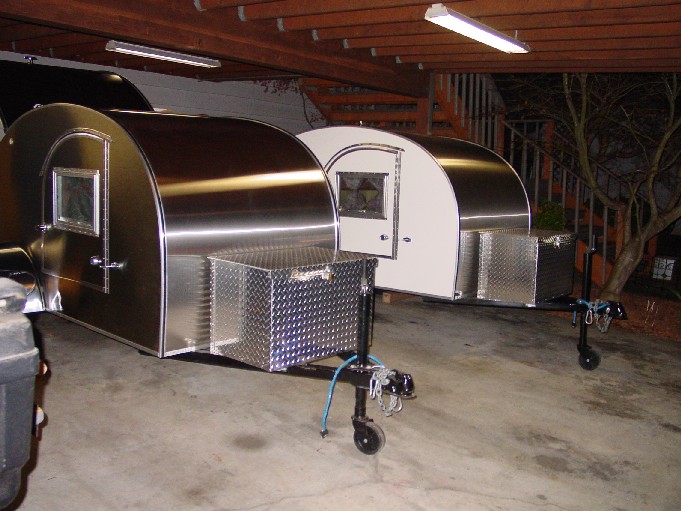

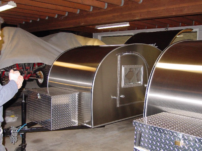

I used brushed stainless on my current TD.
It is aprox. .050 as Kenny stated previous post.
The radius took a little more time, I also used aluminum trim & I have not noticed any chemical reaction, I have dealt with using stainless steel bolts in the past & if you put a regular steel bolt on them they would weld together over time so we always used stainless nuts & lock washers.
I also used mirror finished stainless on my last TD.
Stanless does clean up real nice & easy.
I just picked up 10- 10' sheets of mirrored stainless & around 40-10' sheets of white sheet metal.
So it looks like I may be building a mirror finished TD in the near future, & maybe a few mirror finished battery boxes.
