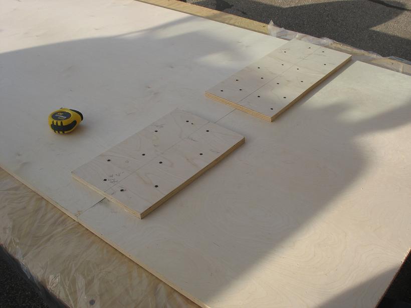

Postby Forrest747 » Wed Jul 01, 2009 11:29 pm
Yellowstone was great. Sad to say I did not see any TD in the RV campground we stayed at. We stayed in a cabin hopefully for teh last time. Yet the road calls again and tomorrow its Vegas.
Yet for teh day I have to work on Charley I made up the joint. a simple butt joint with Gorilla glue and a backing plate. Left the gap in the middle to accomodate the loft frame.
I hope it holds.
