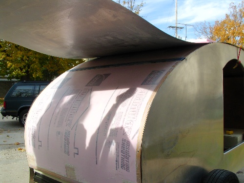

Postby BrwBier » Sat Oct 03, 2009 12:13 pm
Yes, my walls are built the same way. I used spray foam as you can see to fill in around the pink foam board. In the curved sections I used two 1/2" pieces of foam board and in the flat walls I used 1"with the spray foam on the gaps. It made every thing very tight.
