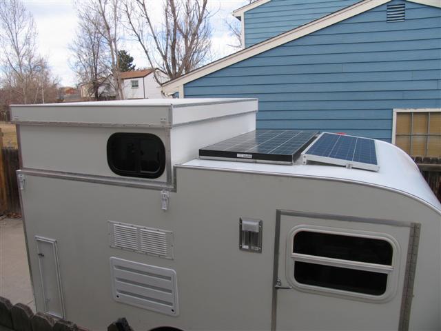

Here it is in the down position for travel. The panel is about an inch above the roof, which is important when using in the down position. Panel output drops with higher temperature so you need space for air to circulate around the panel.

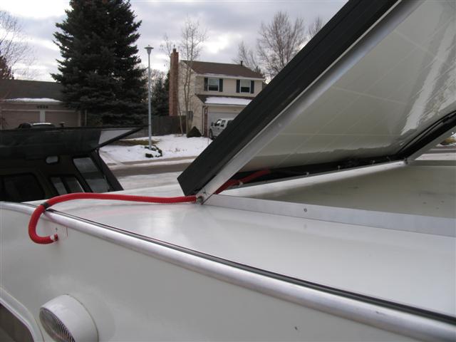

Here is it in the tilted position:

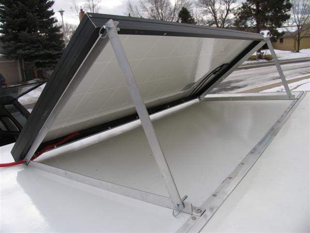

I used 1/4" cotterless hitch pins to hold it in the tilted position as well as to hold it flat during travel. I put the hinge at the front so it couldn't blow up during travel if I forget to put the pins back in or they come out.
This panel has reinforced ends so I couldn't drill through the ends like I did on the 85W panel. I bolted aluminum angle to the long sides instead.

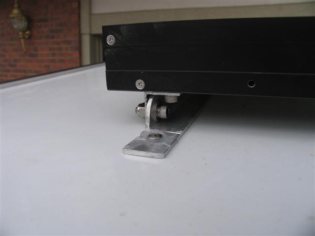

Here's the hinge where it tilts. It's screwed into a spar so its pretty stout. I really struggled with drilling a hole in my roof. Hope it doesn't leak :angel:
I couldn't bring myself to make a hole in the roof while I was building so I brought the solar wiring in through the side of the camper. I still have to seal it up with pucky or something to keep the water out. I only had some red split loom hanging around so I'll probably change that to black sometime. I'll need to tape it to the roof or something to keep it from flapping in the wind.

The panel is 59" long by 26" wide. Its probably overkill capacity but since the new trailer has a diesel furnace that will run all night, I wanted to make sure I had enough to keep up with the increased battery demand. Now I need to figure out how to get on the roof to tilt it without a ladder. ;)

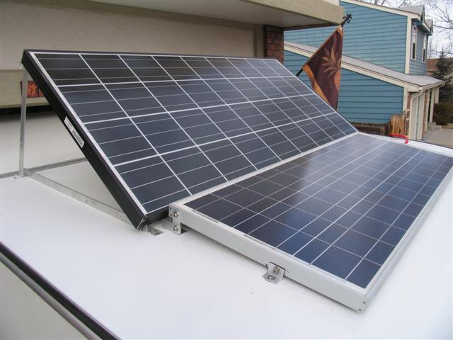

Prices are so low for solar panels right now I added another 85 watt panel. That puts my total at 220 watts.
The new panel doesn't tilt as it would shade the panel behind it. I'll loose a lot in efficiency except during the summer months so I'm curious to see what my output is. Besides, I only have a 10 amp solar controller and the peak output of the two panels is 12.3 amps. I kinda blew it there; I'll probably need to replace it with a bigger one but I didn't think I would be adding another panel. :lol:
No doubt about having to have the trailer face south. The pop top will shade the panels pretty good if its not.
