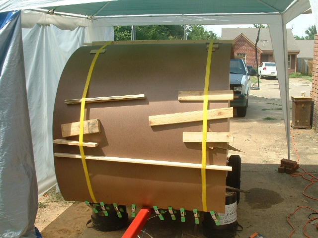

Masonite and TiteBond.....haven't had a problem yet. I did seal the living beejesus out of the masonite before I prepped and painted and the edges do have aluminum molding screwed every 6 or 8 inches.
