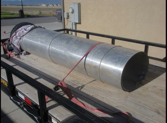

I found a local guy selling a roll of 0.08 aluminum that is 101" wide and 30 feet long for $200. That is almost half of what I'd pay for the 5'x10' sheets of .032 that I was planning on going with. My question is, has anyone on here worked with .08 aluminum before? Is it a pain to work with? Too heavy? I'm not too concerned about the extra weight as my trailer is galley-less and super light so that would actually be nice to have a little weight back there. But I'm concerned about working with the 0.08 and wasting my time trying to trim it with my electric shears or fastening it to the wood walls and framing.
Any insight or advice or whatever on this subject is greatly appreciated!!!

Thanks Tom. The smallest radii I have is at the front corner at 19". The other concern I had about it was cutting it. I'm afraid of me having to use a jigsaw to cut the entire profile. I'm gonna go look at it this evening and see how formable it is and if it feels like it will be too stiff. The guy got it from a tractor trailer supply company and its used as roofing material for the semi trailers.

One thing I was thinking was, it is already coiled on a trailer at the guys house so maybe it having that natural bend already will help make my curve since I am only going for 19"???

You might verify that the thickness is indeed .080" thick. When I looked into wide aluminum roll stock a couple of years ago I was finding .040 at a semi-trailer repair shop. Don't know if what you are looking at is roof coil, but that is typically available in widths and lengths like you are talking about. Have no idea what the intended use of his aluminum was....maybe hoping for your sake that he got his thickness info wrong. Not saying it's not .080".....

I actually thought of that yesterday. I ended up calling the place he said he bought it from, http://www.utility-trailer.com, to see how much it was per foot and the stuff the parts guy said they had on a coil was .04. I'll text the guy and ask him if he knows for sure or if he can measure it with some calipers or something.
*Edit: I called Utility Trailer and they don't even sell a .08 aluminum. The parts manager said he could probably special order a .08 but he hasn't lately. So I'm thinking the guy selling this stuff doesn't know what he has and it is actually .04. Hopefully that is the case!
