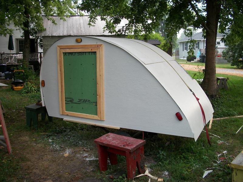

Here is a close up of my cheapie method !
