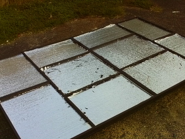

I built my floor and coated it with roof tar. Then I pressed pieces of foil backed Styrofoam insulation into the wet tar. I started to doubt my choice of Insulation when I tried to cut the stuff. But, it was late in the day and I wanted to get the floor done so it would have plenty of time to dry before I tried to install it on the trailer.

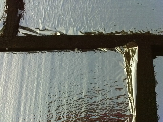

I came home this evening and checked on the drying process. The foam feels like it's firmly adhered to the tar. I planed on adding some screws and washers to help hold the insulation in place. However, I noticed that the foil on the back of the Insulation is already pealing at the corners and edges.
I can imagine that when I'm driving at highway speeds this foil is going to start to peel and it'll look like I've run over a weather balloon.
I'm thinking of picking up another sheet or two of some solid foam insulation and adding another layer over the foil. However I'm not sure about the thickness. I'm not crazy about having the foam stick out past the wood on the bottom as that would interfere with mounting the wood floor onto the trailer.
Also I'm not sure what would be the best way to attach it over the existing foil backed insulation.
Any Ideas?

Hi Kornbread, I used Styrofoam insulation with the foil on my build too. I peeled the foil off because I couldn't think of a way to keep it in place. It peels very easily so I thought it would release inside my walls and ceiling not keeping the structural panel solid. It probably doesn't give much of a boost to the overall R value anyway. To glue my two layers of insulation together I used the 3M foam adhesive from Home Depot and a grooved trowel.

I would cover the entire bottom area with a sheet of luan or 1/4 ply and then seal the heck out of it with your asphalt sealer. Nothing you do with the foil exposed will keep it from coming apart over time.
It looks like you have room to add more insulation and stay within the width of your framing. If you do, you might want to consider adding more insulation, preferably the rigid board type, to fill the void.

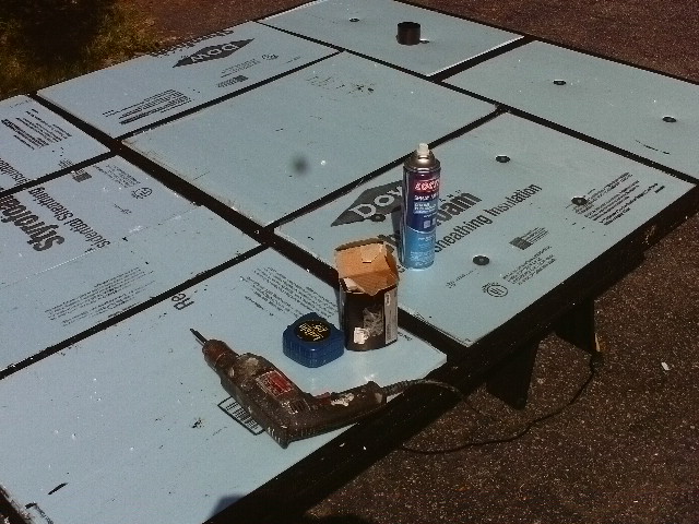

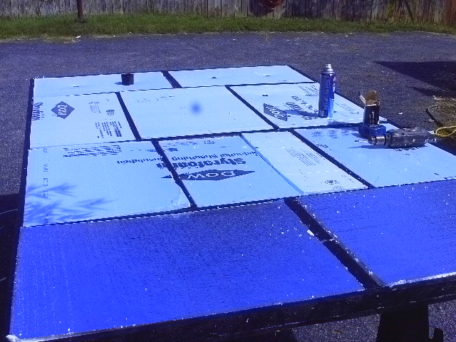

I picked up a second sheet of insulation to go over the foil backed stuff. This time I got the solid blue Styrofoam. I pealed the loose pieces of foil. if it wasn't loose I left it alone. I used some spray adhesive between the layers. The I ran some screws with washers through the foam and into the plywood floor.

One sheet wasn't enough to cover the entire bottom so I doubled up on the foil insulation underneath the galley section. I don't guess that needs to be insulated anyway.
