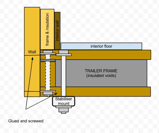

Postby hankyknot » Wed Sep 05, 2012 10:20 am
Below is a quick sketch of my proposed construction detail.
Floor/wall construction detail
Construction Detail 01.JPG (36.74 KiB) Viewed 534 times
The members on the trailer are 2" thick so there will be 2" of insulation in the floor. I looked at the Rvalue per inch of polyISO and it seems to be between 6.5 and 6.8 so a 3" framed wall would give me an R value of 17+ which I think would be fine. I know I need to incorporate a waterproof membrane that isn't on the detail yet but what does everything think of it so far, does it make sense or have missed something?

Postby KCStudly » Wed Sep 05, 2012 3:27 pm
Screwing the wall into the end grain of the floor plywood should be avoided. You would be better off screwing into the long side member in between.
Make sure to seal your end grain extra special. ;)
Re: Insulating your teardrop for year round use?
Postby hankyknot » Wed Sep 05, 2012 3:31 pm
Good point, thanks for the tip
