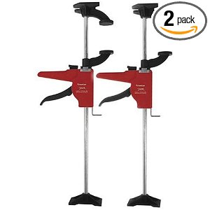

working on it wrote: 96778
Working On It,
Did you make those lifts or did you purchase them? If you purchased them, where did you get them. I bought some FastCap Jacks on [url]Amazon.com[/url] that are very handy around the garage. They are a form of 3rd hand. I like the fact that they are slim.
FastCap Jacks
