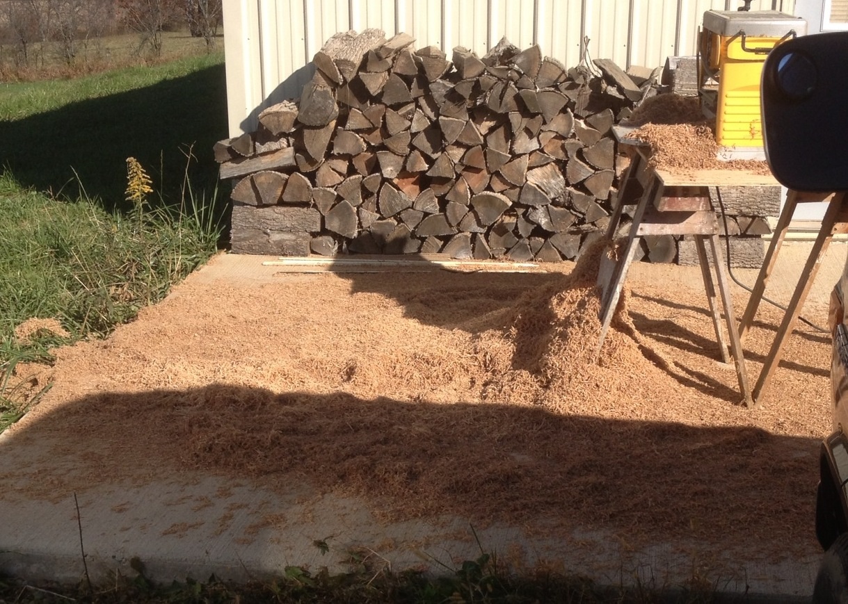

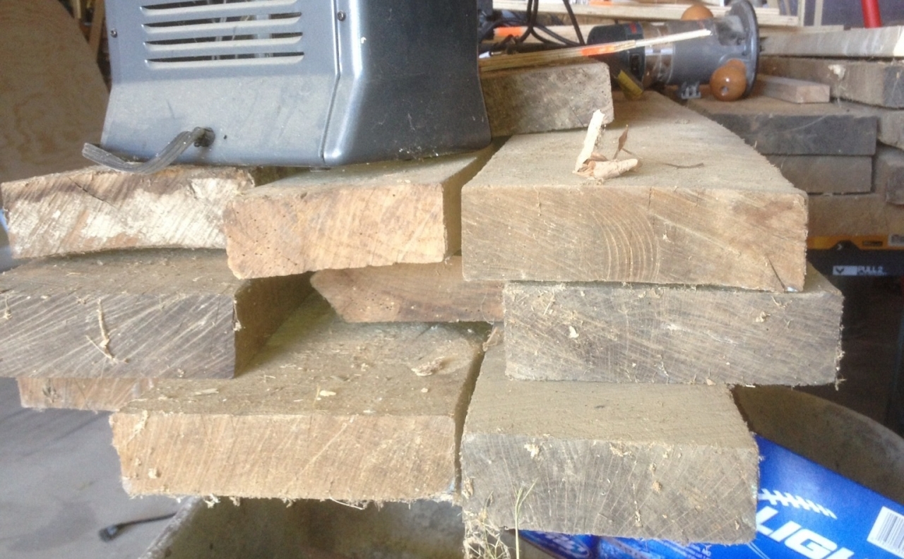

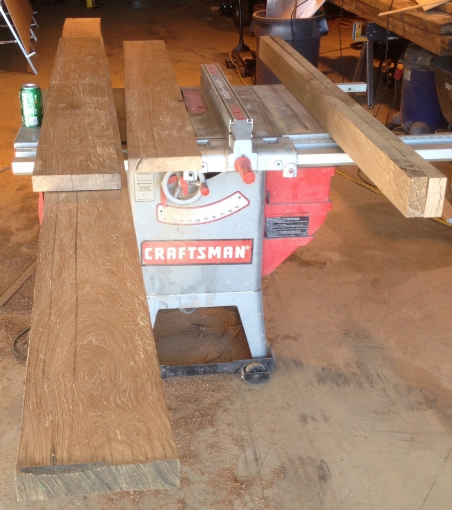

Postby Ben » Sun Oct 21, 2012 7:10 pm
I scored some free material Image so I decided to make some saw dust Image and started to get some boards down to size for my off road benroy Image here's my profile cut out Image
