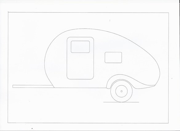

Postby Kody » Sat Nov 03, 2012 7:35 am
This is a true scale drawing showing the finished profile of the TD that I am building. The fenders will be made of fiberglass laid over a foam former. The foam will be removed when finished to produce the glass "shell". The fenders are about 8" wide. These will then be fastened to the sides of the TD. I am considering making the rear half of the fender as a sealed box structure to carry light stuff that will be easy to get to on the road. For a comparison of size and dimensions, the door is 49 1/2" high and 31 1/2" wide. The tire rims are 14". If this shape appeals to you or anybody, feel free to copy, transfer, modify or utilize in your own design.
