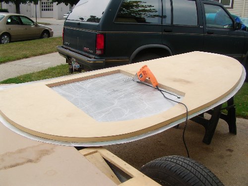

I had never worked with sheet metal before but found it was not too hard. The most important thing I think is to have someone to help. Large sheets can get out of hand and overwhelming without someone on the other side. I don't have a compressor so I got the electric shears from Harbor Freight.
About $40 on sale and they work better than I ever thought.
