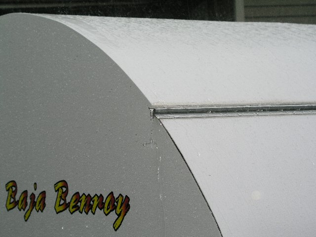

Postby mikeschn » Wed Oct 06, 2004 2:49 pm
Hey, you're making progress. That's a good thing! Nice collection of photos! :wink:
As for hinge photos, you mean something like this?
Or are you looking for some close ups?

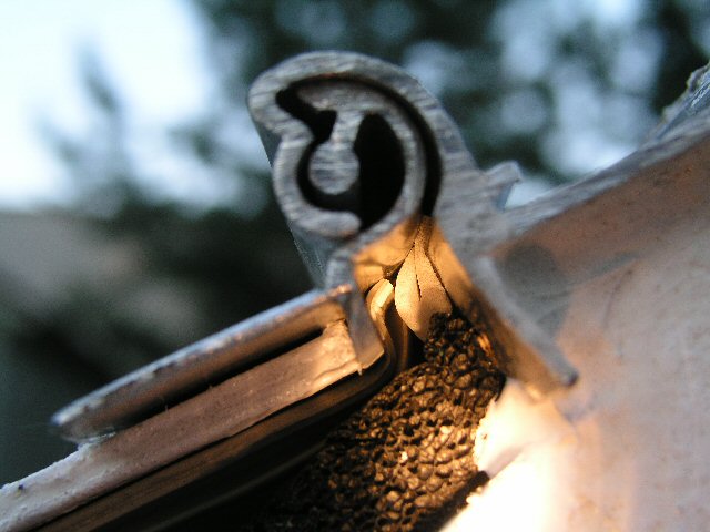

Postby mikeschn » Wed Oct 06, 2004 2:52 pm
I found this one too...
Postby BoilermakerFan » Wed Oct 06, 2004 3:20 pm
Are there other watertight hinge options? Do you have to take the hinge past the edge? I would inevitably catch my arm on it. Don't ask how, I just know I would!

Postby AmyH » Wed Oct 06, 2004 4:04 pm
Very nice close-up Mike. I have been wondering about hinge placement myself, so this helps me out quite a bit, even if I am a ways off from installing it (still working on the chassis :oops: ).
