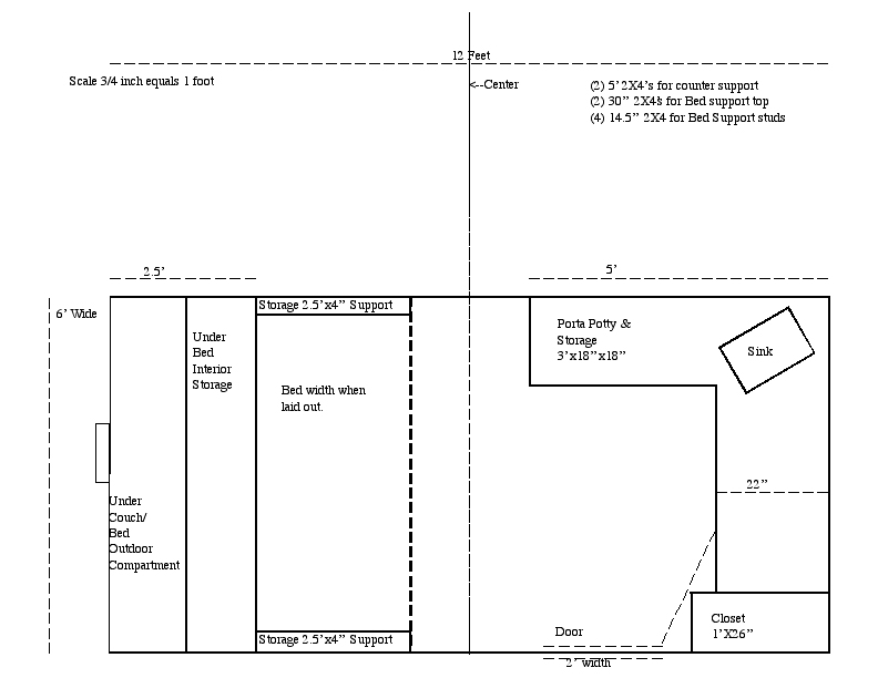

The Inkwell is a TTT. We have an aluminum frame 6'x12' and are aiming to have the interior slightly over 6' tall. While the frame is aluminum the cabin will be made from wood.
Thanks so much for all your helpful information. I've spent a lot of time in the forum, reading and evaluating our design. You'll see in our pics we were aiming to have an angled cut, but after reading some helpful insights about putting in a curve, we're going to give that a try. :D

Postby Lynn Coleman » Wed Jan 24, 2007 8:24 am
Micro469 wrote:Lynn.. Is your bed only 4' wide??? I love my wife... but she doesn't love me that much.... :lol:
I love my husband too but I need elbow room. We've actually planned for a 60" wide mattress. The measurements you see on the diagram is 2.5' plus another 2.5' wide when the bed is pulled out, pehaps the decimal point isn't showing up well in the picture. My grid lines do not copy from PageMaker to any other program.
Thanks for checking.
