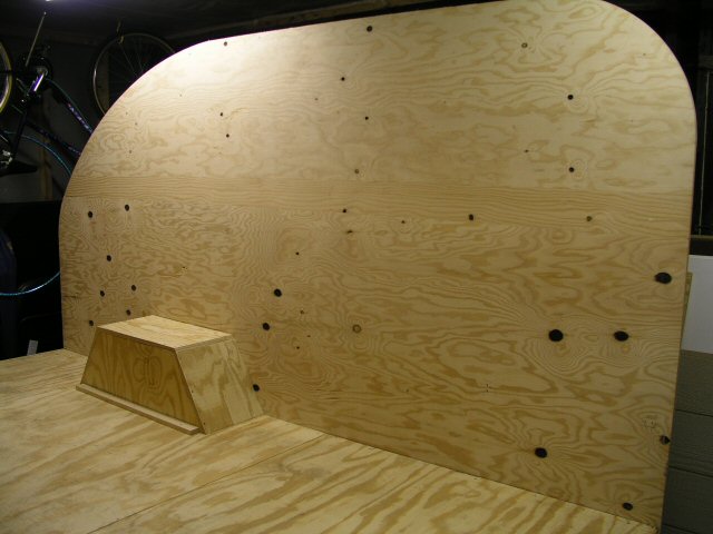

Since my recent catastrophy with falling and squashing my wall, I began to rethink my teardrop build and started to wonder what would I could do differently in my next build. Here's some things I would like to get yall's input on.
Building The Walls and Floors using expensive grade 3/4" Plywood; Is it worth the extra weight and extra expense? How many of you guys build with all 3/4" Plywood and how manyy prefer the 1/2" plywood?
Can I make a tear heavy duty enough and warm enough using thinner plywood?
The expensive sheets of Classic Oak Plywood have cost me $40 per sheet and most of you will pass out when you hear that I have wasted about 7 sheets of the stuff in my quest for the best built tear i can build. Since falling on my wall and watching the expensive grade stuff rip apart, I wonder if I should just go with plain jane old plywood..CDX.
If I built using the thinner 1/2" plywood and skinned the inside walls, would I be just as warm and toasty as 3/4" plywood floors and walls?
I am beginning to think the sheer weight of 3/4" for walls and floors may be way too much overkill. Give me your thoughts on what I can do to have successful build without blowing a wad on expensive plywood. I am ready for the honest, scary truth so sound off all you teardrop pros.

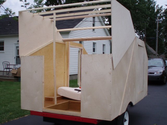

The Escape Hatch was built with 1/2" baltic birch with 1/4" baltic birch on the roof. Fine for 3 seasons camping, and light.
I did the Baja Benroy with 3/4" walls, and I agree, the walls were way too heavy. But I did so because it was the only size plywood the local place had in 5'x10'.
The Weekender was built with 1/4" luan and 3/4 framing and EPS. Perfect for 4 seasons camping and light too.
It's a toss up between how much effort you want to put into it, versus how fast you want to build it.
P.S. My next trailer will have 1/2" baltic birch framing, EPS, and 1/4" skins.

Hmmm..Thanks Mike and MadJack, both have given me some food for thought. I am just kind of tired of wasting the expensive sheets of plywood. For some reason, everytime I mess up, I get that much more determined to build this thing. My wife is loosing her mind everytime she sees a pile of plywood stacked out at the curb on garbage day. She asked how much I have wasted and I am scared to tell her almost $300 worth of wood has gone to the dump thus far. At least I did a great jon the floor. It has been with me though several different attempts. It's bulletproof...just wished I could get the walls the same way. :lol:

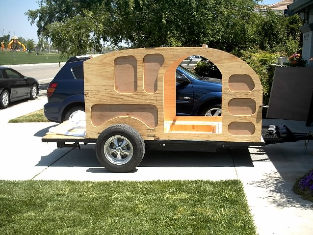

...the only sandwich/insulation is in the roof...3/4" ply walls...1/2" ply floor...consider that one of the best absolute best commercially available Td's is built in/by folks in far, northern, cold a$$ Wisconsin and they just use 3/4'ply for walls and floor...no insulation......

The sides of my trailer are ¾ ply nonstructural parts cut out, insulation added, with 1/8 skins inside and out.
