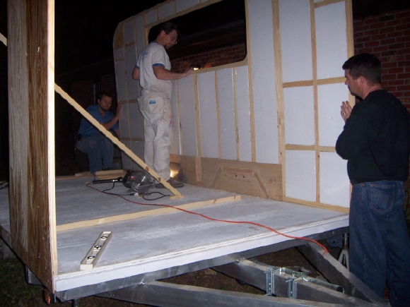

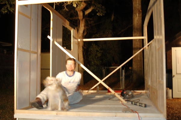

Thanks for the comments. Today we put up the side walls on the trailer. We still have to do some final securing but that will be on Saturday.
Image This is while we're putting up the right hand wall.
Here's a slightly blurry picture after a few supports and the two walls are up.
We're actually very excited that the two walls went up. We did need to do some slight trimming around the wheelwells but apart from that it was an easy wall raising.
Saturday we hope to get it fully secure and some of the front and back exterior walls up.

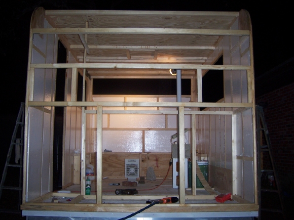

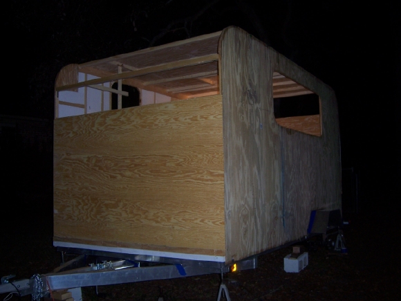

Well, we managed to get a few things done on the Inkwell since I last posted. The roof is on and secured. The exterior front and rear walls are on. And the interior rear wall is in.
We've discovered we'll be using some sort of trim to hide some of our many mistakes. This will be done much later after we're certain we haven't made any more. (Don't worry, we anticipate there will be many more.)
We had rain this past weekend and one of our exterior plywood panels became a sponge. It now has a little bubble but went down tremendously from when we first spotted it. One of the things we did to keep the water at bay was to set up a space heater in the trailer and have it drying out the walls as much as possible. In the end we'll probably have to remove the warped piece of wall and replace with a spline. Something we learned how to do from another mistake.
Anyway, here's a couple pics to show the progress
This is before the exterior front panel was put on today.
This is a shot after we put on the front panel.
And last but not least here's the interior rear wall in place.

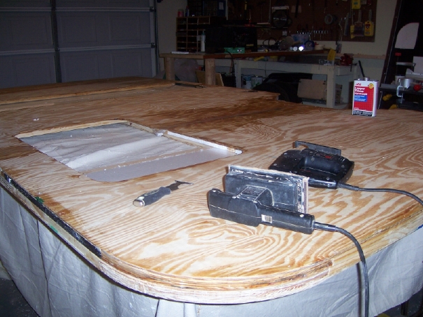

Today while hubby is working I'm sanding the exterior ply and getting it ready to be sealed and painted. Thankfully, there are no cameras around. :D

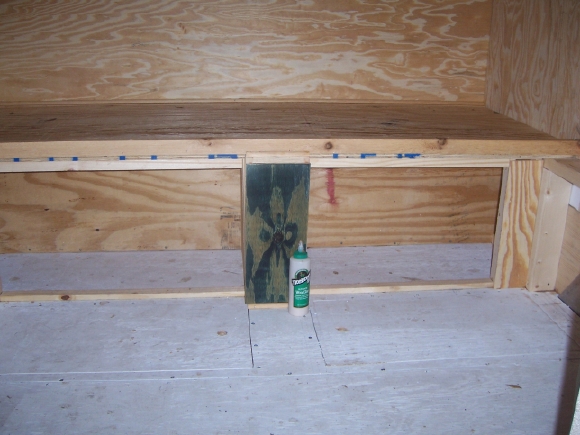

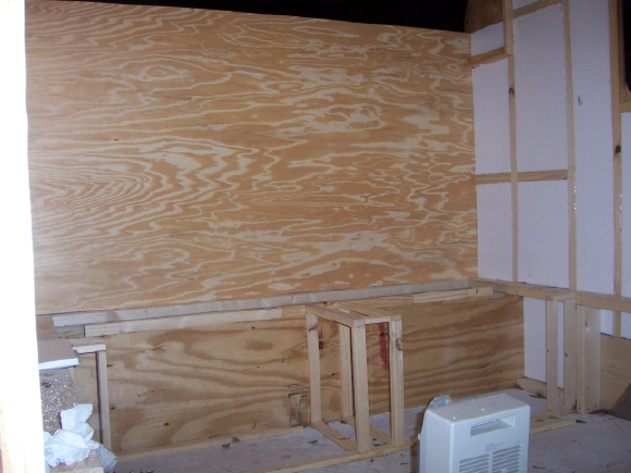

Well we had a busy day today. We put the interior rear panels up. The couch/bed is in. The portapotty cabinet is framed. And last but not least, the front bend on the roof is on.
Here's a picture of the couch/bed.
You'll see a green stained board that is a leg, that sits on a 3/4" board on the floor, so when you pull out board to turn the couch into a bed, it will have a middle leg for support. Tomorrow I'll begin the process of several coats of polyurethane.
You can see a bit of the interior rear walls around the couch.

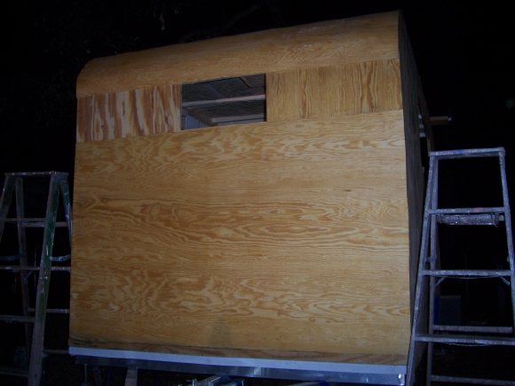

Finally we managed to get a board to curve around the very tight curve of our frame. When I joined this forum, someone (I believe it was Brick) suggested that a curve wasn't that difficult...ugh! It looks pretty but it has been a process and we're not done yet.
Here's the exterior shot taken tonight as the panel is drying in place on the Inkwell.

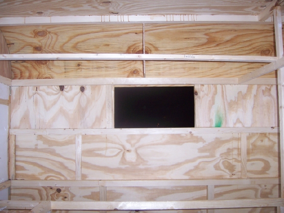

Here's a shot of the interior where you can see the many scores we had to make for this wood to curve.
