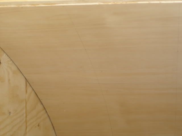

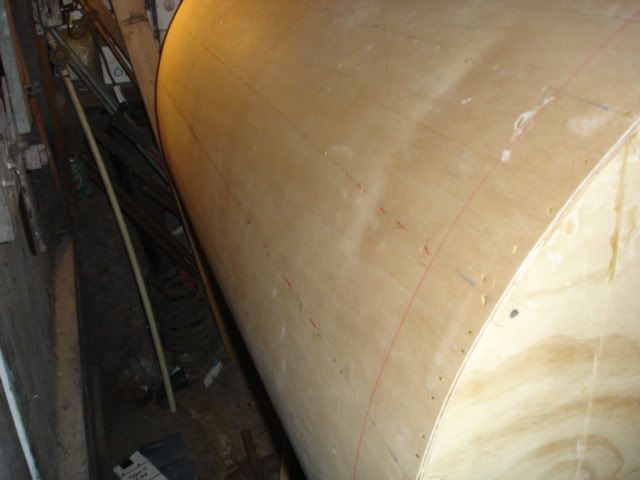

I have my entire tear skined on the outside and have only on more interior panel to cover inside,the wall opposite the door. I should receive the windows tommorrow so I can cut those out and test fit them. I started on the galley today, I got a nice old icebox out of a junk camper we have been salvaging,My wife has been stripping the old latex paint of them,then I will sandblast them lightly and spray them with some automotive PPG 2K urethane,probaly white.I am going to replace the thin layer of fiberglass insulation with some 2" R-Max ridged insulation. I am doing some cool things in the galley,it will be kinda "U" shaped and will have curved cabinets. The IceBox will be in the center and the stove will be on one side with the sink on the other.
I am going to mount the trailer frame this weekend if my help shows up. do You guys use carriage bolts to mount the body to the frame or just hex bolts and fender washers or? Also I was thinking of putting down a layer of kraft paper (similar to roofing felt only thinner) under the aluminum skin on the roof or would this be a waste of money? I do have a gallon of school bus yellow urethane I got by mistake and could spray that on the sheeting before I apply the aluminum,it cost me $150 but I will neveuse it anywhere else!
Thanks! Aaron
