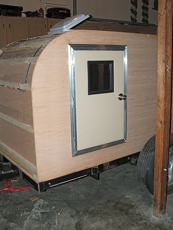

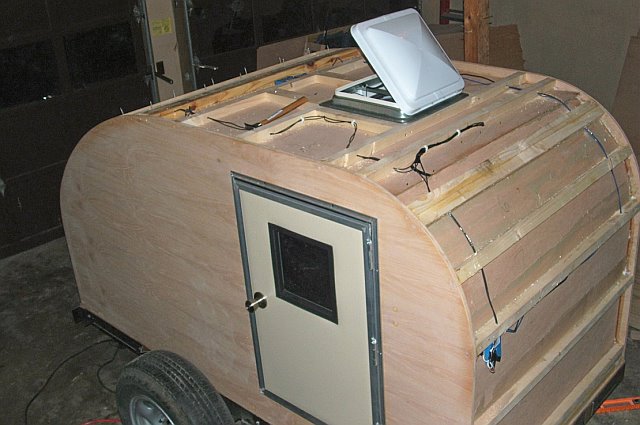

Outside shot of Tear and Wiring
Side Shot Of Tear

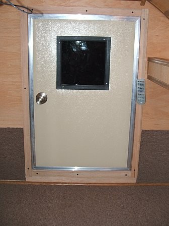

Inside Shot of Doors---How do you like the Doors?

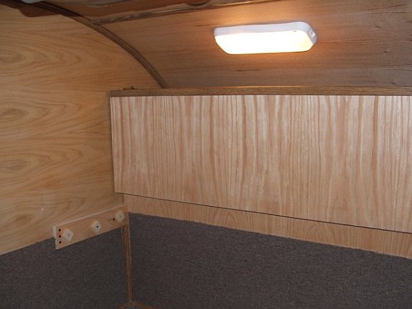

Bunk For my Daughter
Bunk Folded Up

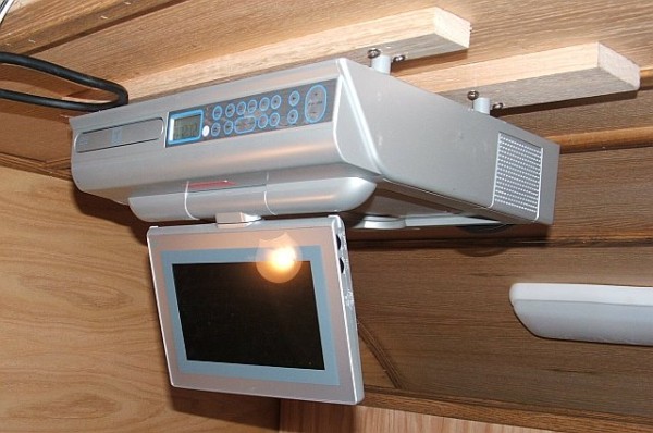

TV,DVD, and Stereo---Nice All in One

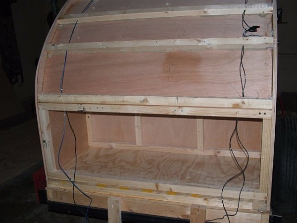

Storage Area For Camp Stove, Battery, Etc.--Just Started

Wow, I gotta say that I really like that bunk and catch all shelf. I'm going to start building a Benroy based teardrop myself. Would you mind if I used those two designs in mine? Also, where did you get that door? Can I ask how you made the bunk? It looks like it would be 2x4 framing covered with plywood, is that correct?

Thank You---The Bunk is Made of 2x2's With a 2x2 triple Stacked in front so my daughter wont roll off . Then i just Covered it With 1/4' oak Plywood and Trim. The doors are From http://www.eaganmfg.com/.
They Have All Kinds of Doors and Can Make any Size. They Also Can order Roof Tin Cut to Length. Talk To Richard Eagan. The Bunk Is Hinged so It Will Fold Up
PS:Use all the designs you need, I come up With that idea one afternoon while putting spars in. Thats when I decided i didn't need a Galley, But i did need a storage area

Really looking good there!! I thought you had a remote control door for second or two, until I saw the tv unit. :lol:

hi chris lookn good i like the door iam planing on building a benroy this fall what size is the door once again great job :thumbsup: :thumbsup:

The Door is a 24" Wide x 36" tall Insulated. The Carpet is just indoor outdoor. just wanted something to cover plywood since matress will cover floor.
