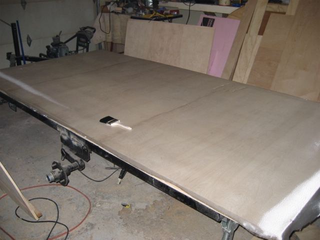

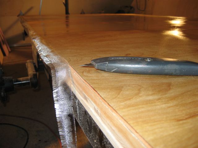

Postby Juneaudave » Wed Jun 27, 2007 8:08 am
It is common to use glass and epoxy on wood boats and canoes...but you need to buy glass and resin designed for clear coating. In your application, where your not looking fro strength, you may not want to go to the effort of laying on the glass and just use resin to seal the surface. Here is kindof how it goes.
Lay out your glass, being carefull it doesn't snag....
Put on multiple coats of resin to fill the weave and give you a sanding surface...
Trim the edges....

Postby Juneaudave » Wed Jun 27, 2007 8:56 am
That's Raka 4 oz. plain weave. It comes in a 60 inch width, which is tough to find, so you don't have to overlap on a 5 ft. panel. Typically, I use a 6 oz. on a canoe. When you start going less, you have to be much more careful handling the cloth. Here's is the link to Raka's cloth. Raka Cloth

Postby doug hodder » Wed Jun 27, 2007 9:41 am
Diver guy...the only trick to laying down a layer of glass so that it is invisible is to wet it out really well as you do it...I lay my glass down on bare wood and wet it out with a squeegee...The sides on this boat have a layer of glass on them, none on the top deck and it's pretty hard to see the fiber unless you are right up on it...I haven't used the cloth on any of my tears, just resin on wood...Doug
