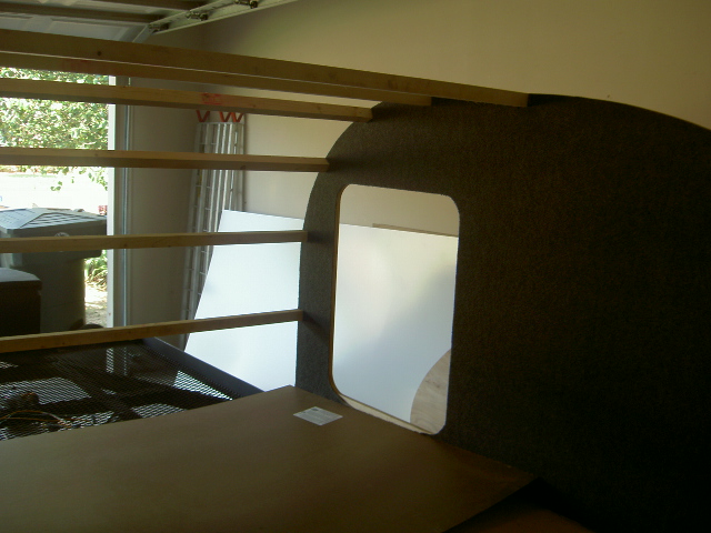

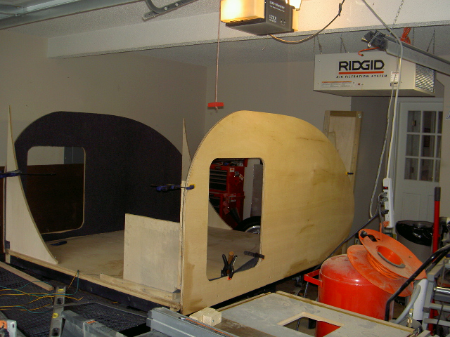

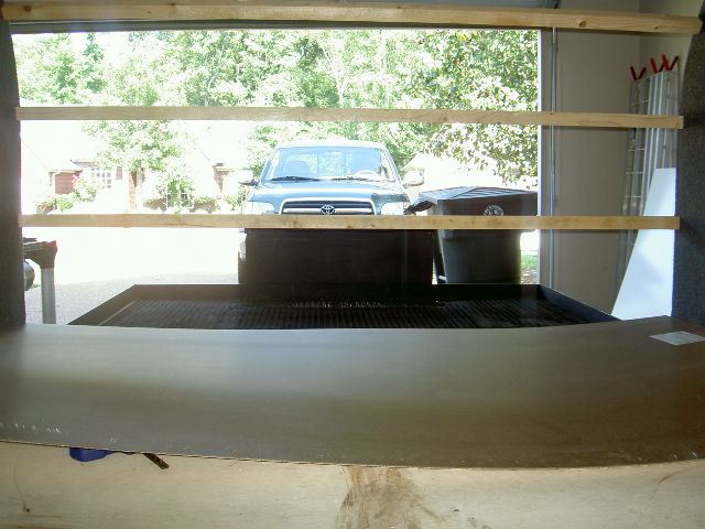

Postby sandman » Wed Jul 11, 2007 2:52 pm
Thanks again for all the nice words and great advice!!!! I could not do this without this site and all the great members. On a side note, to those who have gained pearls of wisdom and haven't donated to keep this place going, I strongly urge you to dig into your pockets and donate to T&TTT to help Mike out. Believe me, it's a lot of work and expense to keep a site like this going. I am also a site admin of a dirt biking forum and depend on my fellow forum members to help bankroll the site. Ok, enough campaigning or begging for donations... 8)
I managed to put in 3 roof spars yesterday using Titebond III. I got some ratchet straps and pulled the walls together to provide constant clamping pressure while the glue set up overnight. I decided to only install 3 spars at a time and then clamp them and walk away for 24 hours. This seems to be working VERY well. I am being extremely slow and patient this time around and so far it has paid off. By tomorrow night, I will be back at the same point in my build as when I experienced my catastrophy.
One thing I love about using Titebond III glue is the easy clean-up. When installing my spars, a bit would drip onto my carpeted walls and I could simply wipe it off with a damp rag and it didn't even stain the carpet. Gorilla Glue would have ruined my carpet plus the clean-up is a real BBBBBBBEEEAAAAAATTTTTCCCCHHH!!!!.
Here's some pics of yesterday and today's progress.
