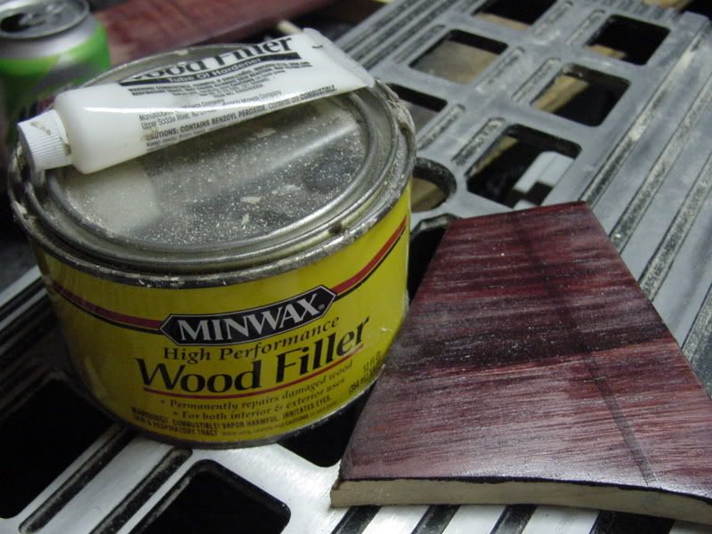

I tested Minwax Wood Filler a 2 part filler with a added hardener.

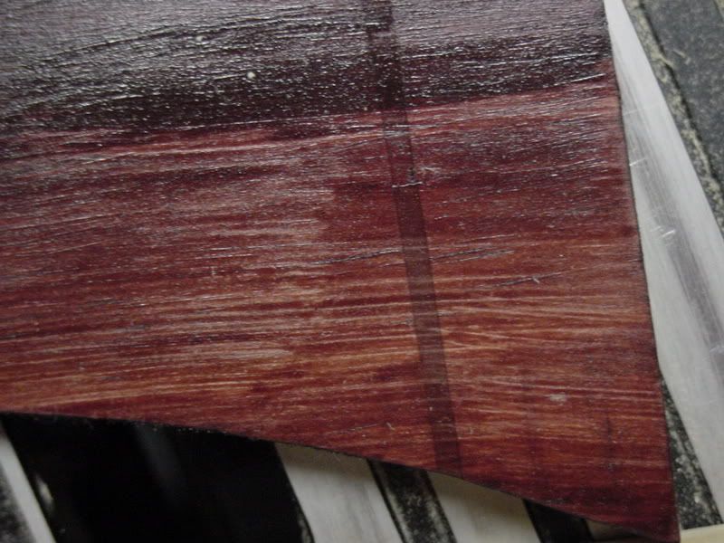

A closeup of Minwax

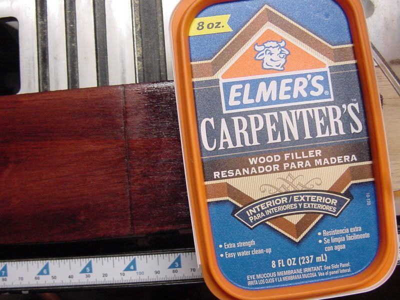

Here is Elmer's wood filler

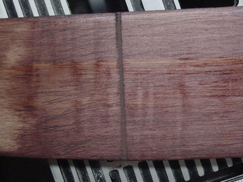

And Lastly PL wood filler.

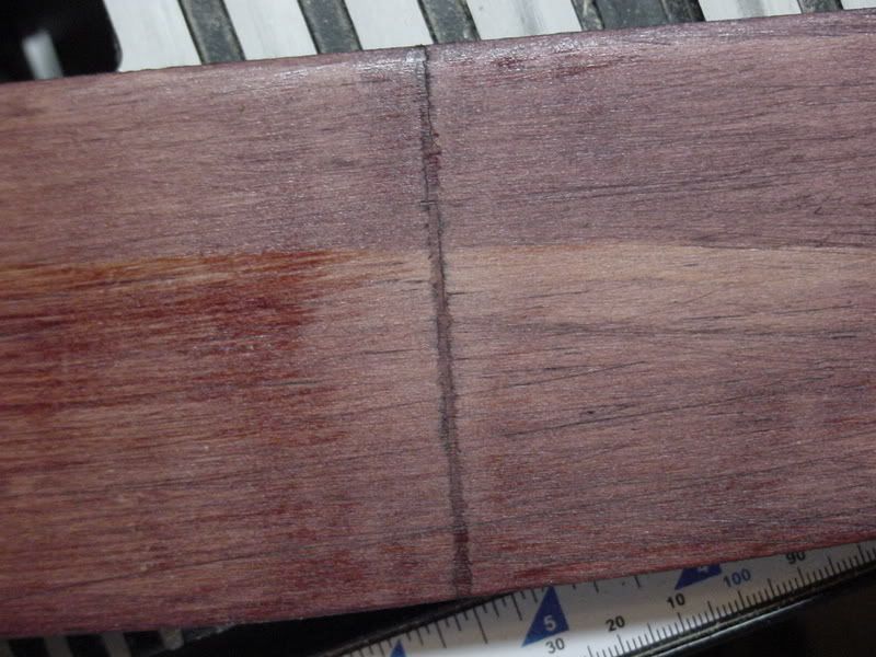

A Closeup
Being a beginner woodworker some of my joints on the trim were not exact.. :oops: Imagine that huh? So I need a wood filler. I figure for the small gaps between joints, any of these fillers will do. They all seamed to take the stain. But I am going to use the Minwax. It dried quicker and sanded smooth.
The Elmer's look more like wood grain than the PL, but did crack when I put some pressure on the board.
