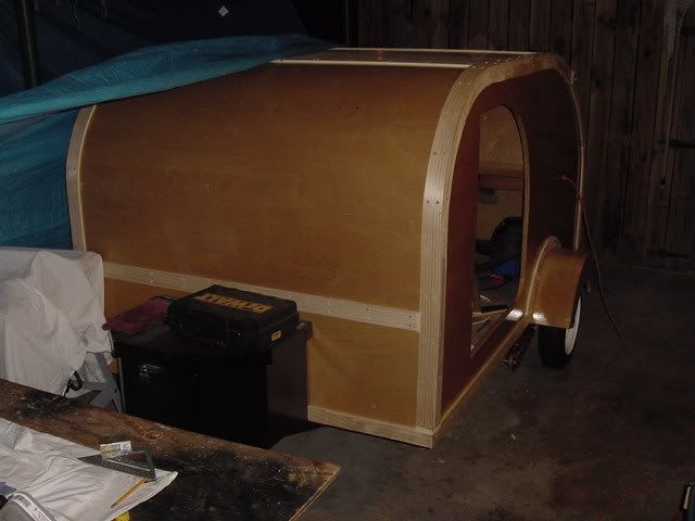

Except for the doors all the trim is on, plugged and filler added. I am waiting to get the doors on before I start all the sanding to the trim.
It looks rough with the filler everywhere and plugs poking up.
:question: MadJack,
What do I do with the overhanging hatch Hinge & trim. Do I trim it back even with the side trim & diverter. Or should i leave it hanging over like it is and finish it (sand, stain & poly).
Thanks,
Mk

Postby madjack » Thu Aug 16, 2007 3:53 pm
MK, that is looking great...as to the divertor, I would trim it close(a coping saw, maybe?) and keep in mind that you may need to stick a piece of flat weatherstripping somewhere in the gap between the hinge and body to get a completely watertite seal...

Postby Mary K » Thu Aug 16, 2007 4:13 pm
Loader wrote:Looks great Mary! Look forward to seeing it at the LCG!
(oh, and meeting you too!)
Thanks Earl. Yes, I'll be seeing you at LCGII... :twisted: tehehe
mandy wrote:WOW!! Mary
If I could do half of what you have done with you TD I would be Proud.
:applause:
Mandy
Thanks Mandy, if I can do it, anyone can. Ya just have to figure out how and just doit!!! BTW, I am proud. I really can not believe how well it has gone together. (Not including the interior trim) :fb
madjack wrote:MK, that is looking great...as to the divertor, I would trim it close(a coping saw, maybe?) and keep in mind that you may need to stick a piece of flat weatherstripping somewhere in the gap between the hinge and body to get a completely watertite seal...
madjack 8)
Madjack you ROCK!! :thumbsup: I was hoping I could trim it back. (See Mandy, I have to figure out what a coping saw is now) Weather stripping? I need weather stripping?? :lol: Ha just kidding!!
Mk

Postby Steve_Cox » Thu Aug 16, 2007 6:58 pm
I'd cut the hinge and it's supports to match the side trim piece. It's lookin awsome Mk. :thumbsup:

Postby steve wolverton » Thu Aug 16, 2007 8:34 pm
It looks lovely MK.
I do have a question though - how do you keep the water from pooling on top with the trim creating a box up there?
