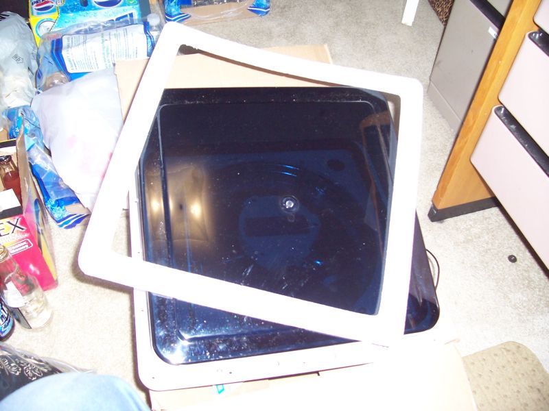

Postby Micro469 » Wed Sep 12, 2007 9:10 pm
It's a 3sp, reversable, smoked hood. Sorry for the lousy pic...cheap cam.The gasket is on top.
John

Postby halfdome, Danny » Wed Sep 12, 2007 9:55 pm
Micro469 wrote:Image
That white foam that's is shaped like a picture frame is the gasket. Danny ;)

Postby Classic Finn » Thu Sep 13, 2007 2:18 am
Nooooo such contraption in the box..
