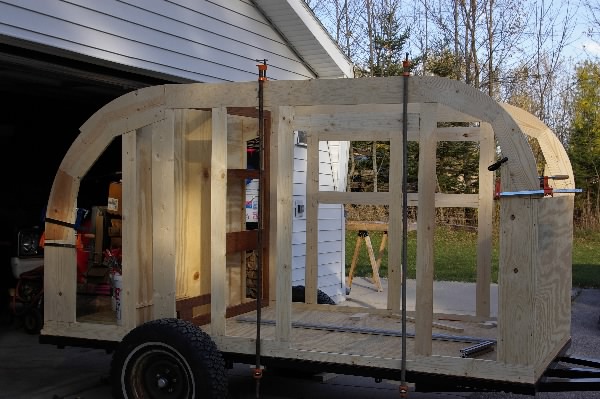

Postby Chuck Craven » Mon Oct 22, 2007 8:53 pm

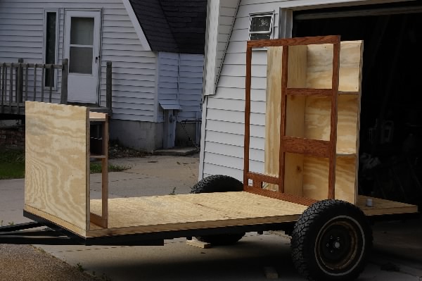

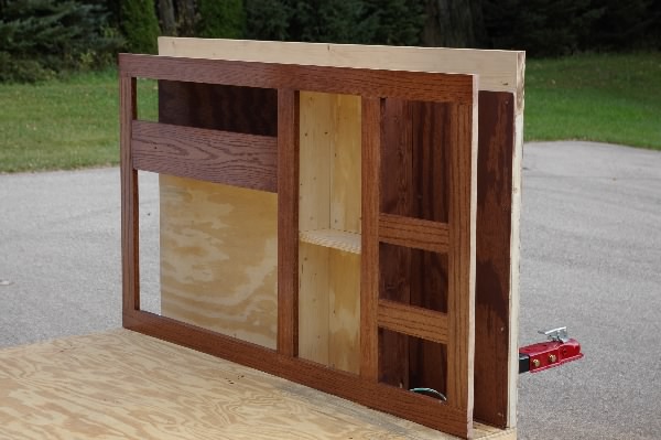

This is the front bulkhead and front cabin storage cabinet.
There is an open shelf on the top left side with a cabinet under. The doors will be added over the winter months. Center is also a cabinet with a self. On the right side will have the two electrical panels with the 12v power supply and battery charger above,

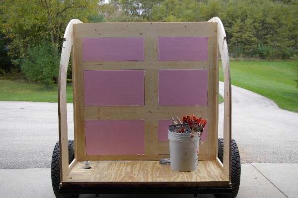

This is the galley bulkhead and rear cabin storage cabinet.
The doors will be added over the winter months. On the left side is a hanging closet.

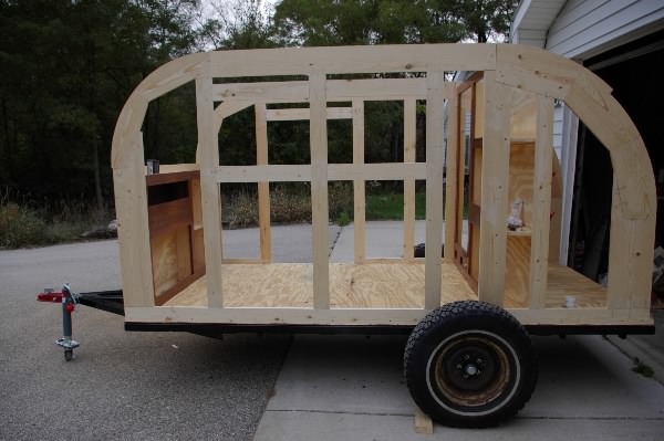

The sides are all framed up.
From the galley side.

Postby Miriam C. » Mon Oct 22, 2007 8:56 pm
You have a really great start Chuck. How tall is it. Looks big. :thinking:
Postby Chuck Craven » Mon Oct 22, 2007 9:02 pm
The body is 5 feet by 5 feet and 10 feet long. From the ground to the top it’s 6 and a half feet tall.

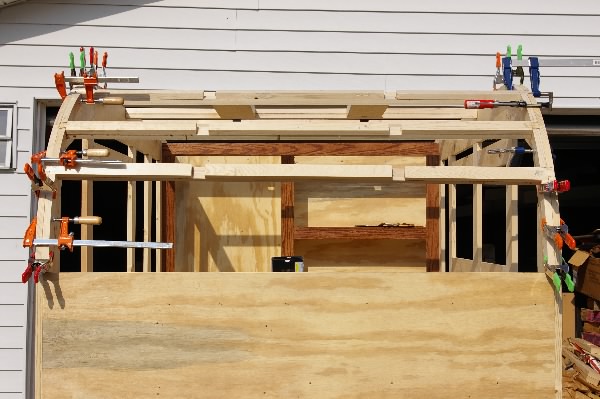

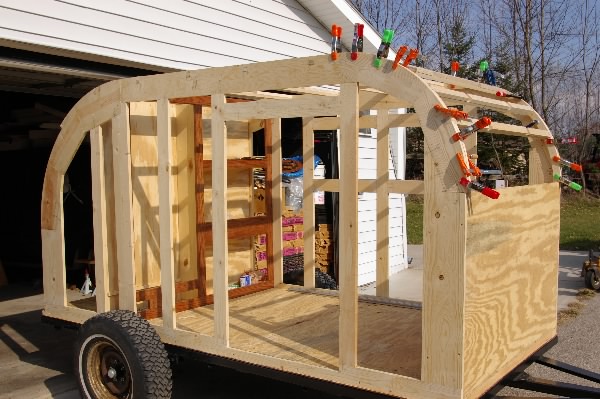

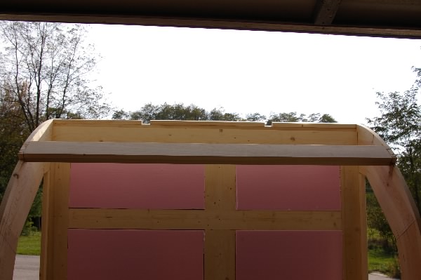

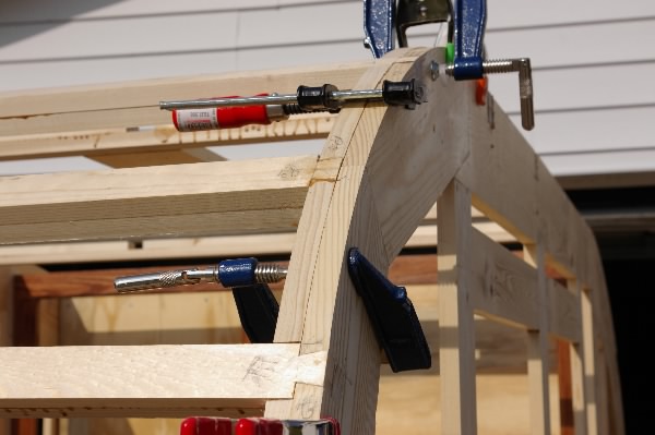

Postby Chuck Craven » Mon Nov 05, 2007 7:44 pm
Well I got some more done!
Front view of the roof.
Closeup of the struts
Galley end view
Side view

Postby Miriam C. » Mon Nov 05, 2007 8:08 pm
Impressive framing job Chuck. :thumbsup: Thanks for the pictures. Your roof spars are a great idea. ;)
Postby toypusher » Mon Nov 05, 2007 8:15 pm
Dovetailing the spars is indeed very impressive! That is great work and should never come apart!!!

Postby Chuck Craven » Mon Nov 05, 2007 8:19 pm
Thanks.
It took some time to figure out how to do this. I still have not decided to cover the roof with plywood or just a sheet of .062” aluminum. So I hade to do it with out screws, this way I can put a screw any place I want to once I decide. The struts (Spars) sure did tighten up the sides. Now I can push on the sides and the whole trailer moves.
