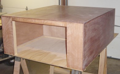

Here is an “Explorer Box” freshly CPES’ed, sanded out and waiting to be top coated.
