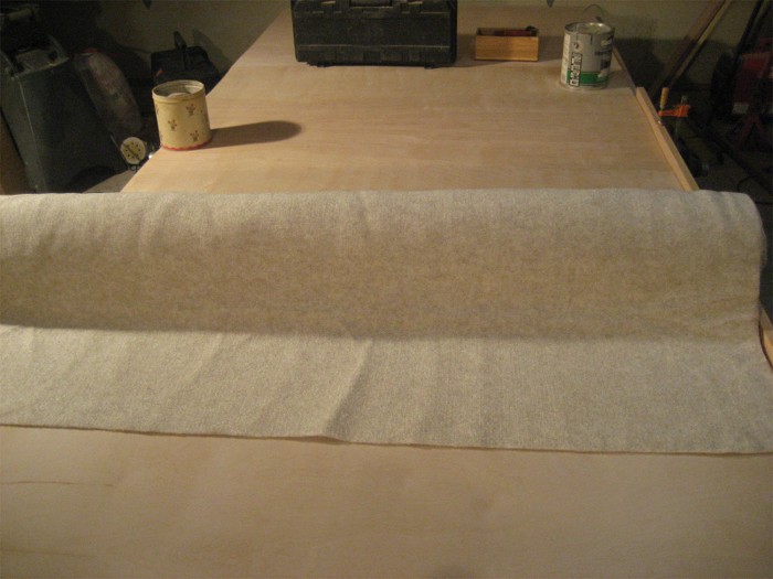

So I bought a bunch of this 72 in wide hull liner material last year thinking to use it as a headliner, on the floor and partway up the sides. Hull Liner Seems like pretty good stuff. The company was real good to work with.
Anyway...I glued up the 1/8 birch panels this morning for the headliner. And laid the fabric out...
Here's the questions...I know I need spray automotive headliner glue to fasten the hull liner to the 1/8 birch ply.
    Do you need to seal the birch first with poly or a varnish wash?
    And do you need to spray both the back side of the fabric and the birch with the headliner glue (or just the birch?)
Thanks all...Juneaudave ;) ;)

Uhhhh, I guess this did seem like just another stupid question...So I ran out to the store and got some glue...and the can says apply to both the fabric and the surface, mystery solved. The can doesn't say anything about sealing the backer, but I think it couldn't hurt.
Thing was (with my pea-sized brain), it seems like the last time I did one of those glue in place headliners, the backer was only a formed stiff cardboard-like material...and the glue was not like a contact cement where you stick it and its stuck...you applied it to one side and could move the material around a bit to get it to fit. Old age I guess....

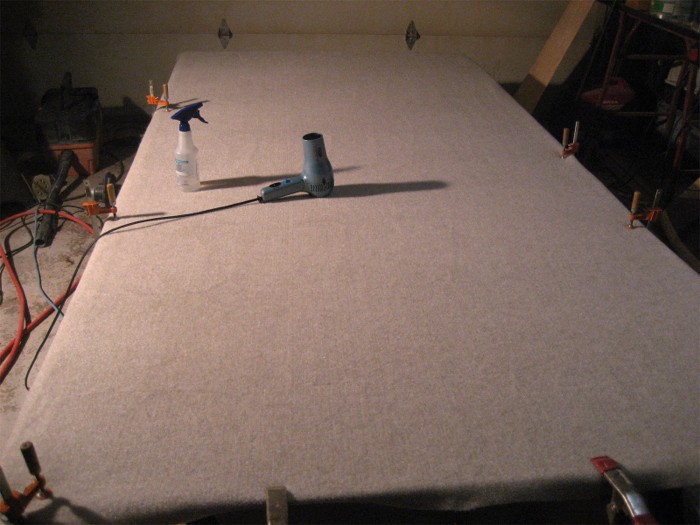

I rolled that hull liner out this morning on the sealed ply. Much to my dismay, it was all wrinkled up. Because I'm in Juneau, the supplier couldn't ship the 72 in stuff on a roll via UPS ground...and had taken the roll and carefully folded it in a box. Well......
So...here's what I've been trying to get the wrinkles out and relax the fabric.
I rolled it out and have been gently smoothing it while applying heat via a blow drier while spritzing with water via a sprayer. As I work it, I've clamped the ends (trying not to stretch the hull liner) to keep it tight. Seems like it is working...hope this turns out!!! Once it relaxes, I'll give the glue thing a try.

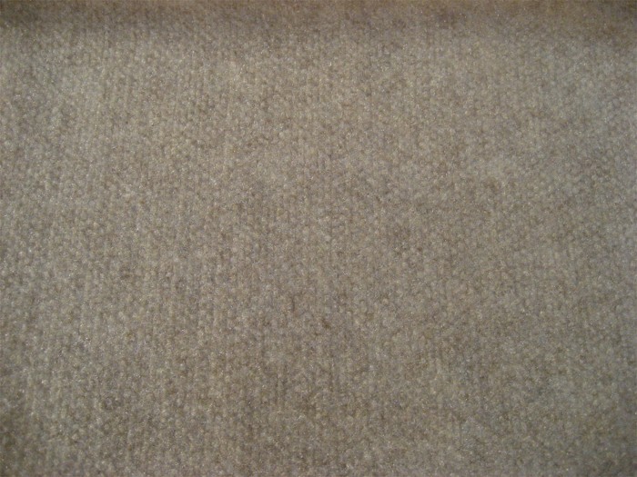

Just what is "Hull Liner"? Some special cloth? Cloth on foam?
Hull liner was developed for the marine industry as an inexpensive way to cover all those Fiberglass panels that might get seen, but never used. It is mainly used in bow sections to cover any exposed glass such a fishing pole storage bin, behind control panels etc. its main function is to cover the fiberglass aesthetically
