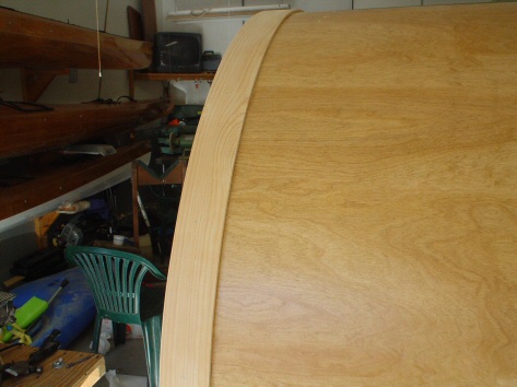

Postby b.bodemer » Sun Feb 17, 2008 1:52 pm
I used 1/4" thick by 2 1/2" trim to cover my roof screws. At 1/4" it took the front 24" radius with no problem.
Trim work took a lot of time but was well worth the effort to hide things.

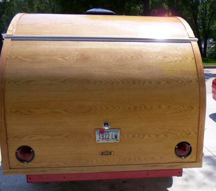

Here's a couple pics of my Benroy woodie. I used construction adhesive (PL something) on the roof spars and along the edges, then bent the roof plywood into place. I used construction screws to tighten everything down placing screws along the edges and along the roof spars. After it cured (I waited about 3 days) I went back through and removed the screws into the spars. I left the screws along the edge and covered them with trim like Barb did. The screw holes from the ones I removed I filled in with oak wood filler and sanded flush (as in the first picture). The whole thing was covered with epoxy sealer from The Rot Doctor then 8 coats Spar Urethane applied (second picture). By the way, one thing I learned was to use all brand new screws instead of reusing the same screws I had removed elsewhere. They left a cleaner, smaller hole to fill than the reused screws which tore up the wood a lot more.
Can't hold a candle to Steve's beauty, but I'm proud of it anyhow! Hope this helps!

Postby kiacker » Thu Feb 21, 2008 3:54 pm
Hey Thomas,
Yes, the top trim over hangs the side trim. I used 1/4 oak trim boards (can't remember how wide - I think about 2 1/2 inches - used millwork lumber) for most of the trim. I cheated on the curves and used 1/4 inch oak ply cut in a curve so I didn't have to bend it. (Was tired of building at that point and just wanted to get 'er out camping!) Others here have done it differently and ended up with a nicer finished appearance. I attached the trim with the PL adhesive (had considered epoxy but just didn't have the experience with that) then screwed it down as well as threw in some brad nails. Helps to wet the wood first then bend into place. I used pieces of scrap wood to drive the screws through into the trim so it would have a wider "footprint" to hold the trim instead of just around the screw. After it cured, I pulled the screws and filled the holes. I did have a piece of my top trim near the hatch which let go and popped up after the tear was finished and I was camping. That piece I did use epoxy then screws to reattach it (removed the screws after a week and filled the holes with the epoxy mixed with red oak sawdust). The epoxy did hold the best. If I did it over again I would use epoxy not the adhesive.
I attached my top trim first, making sure to have a little more than 1/4 inch overhang on the sides. I then attached the side trim. I took a sander and smoothed the top trim edge to be flush with the side trim surface so it was a nice square edge. I sealed all the trim edges where it met the top/front or sides with silicon caulk so any gaps would be sealed. Then came the epoxy sealer & spar urethane.
What I have learned here is that there is a million and one ways to do a great job at building a tear. I took many different ideas everyone had to offer and put them into my tear. The sweetest thing was how the woodgrain came out after she was finished - I didn't expect that. Be sure when you buy your wood to buy the best quality you can afford and get all your side,front, hatch, and top plywood at the same time. Then you'll end up with pieces that are very similar and maybe even matching like mine were. I also bought an extra sheet than I had figured for - always a good idea in case of cutting errors! :lol: (I speak from experience! :lol: )

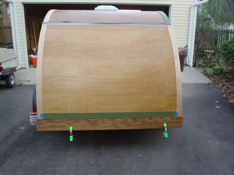

Postby Mary K » Thu Feb 21, 2008 5:47 pm
Here are some pics for you.
I skinned (birch) the sides to cover the screw holes.
And I PL glued the 1/8" birch skin over 1/8" luan.
Before
After
I did the same as Barb and Steve Cox and glued & strapped the skin down over the TD and used sandbags and shims. Potting mix bag came in handy too.:lol:
