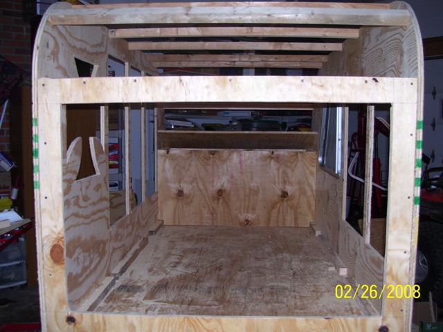

Nephew needed project and I was a bit selfish.....needed an experimental project to test out some ideas before I build my own!! Seems y'all give great advice when you are looking at builds so we thought we'd share the "experiment". :twisted:
Did this much in about 14 total hours and gonna skin the interior tomorrow. Trailer has a few more hours in it and should be done later this week so the cabin and trailer can be joined. :worship:

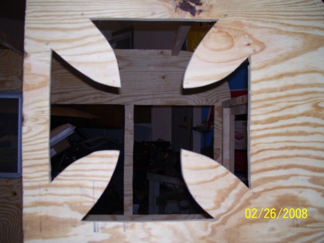

Tell me more about this... is it a window? Are you going to put the glass on the inside? Black glass, right? :lol:

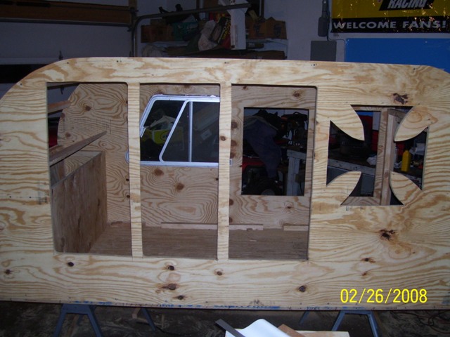

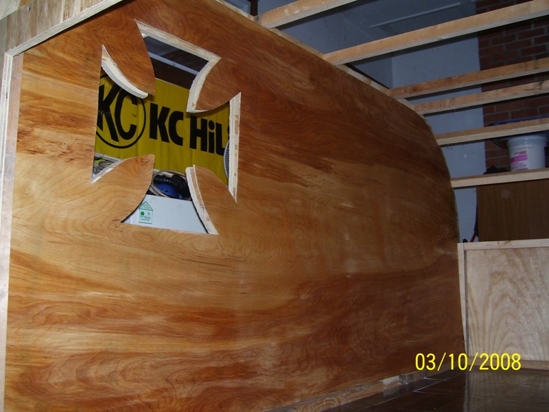

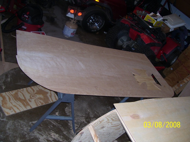

Yes, it will be basically a window. using 1/8" lexan clear for in side and 3/8" on outside. To expensive to buy the lexan tinted($80 total for what I'm getting now) so we will tint the inside surface of the outside piece. Going to seal the edges and use bolts with plastic chrome caps on every "corner" of the Cross. Bolts will pass through wall and secure both pieces of lexan. Going for the 3d look on the outside.

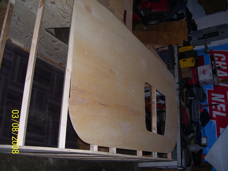

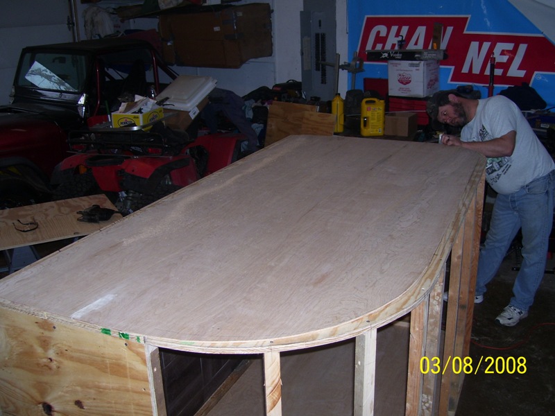

Other window from a motorhome and the door will be on the rear. Just finished cutting the skin for the first interior wall and ot came out AWESOME :thumbsup: . Second skin started and will continue after a bit of lunch!!
When I return I will post today's progress!! Wish me luck!!
Question..thinking of using floor tile adhesive for securing skin. Cheap and easy to work with. Any drawbacks? Don't like liquid nails and limited variety at local hardware. :thinking:

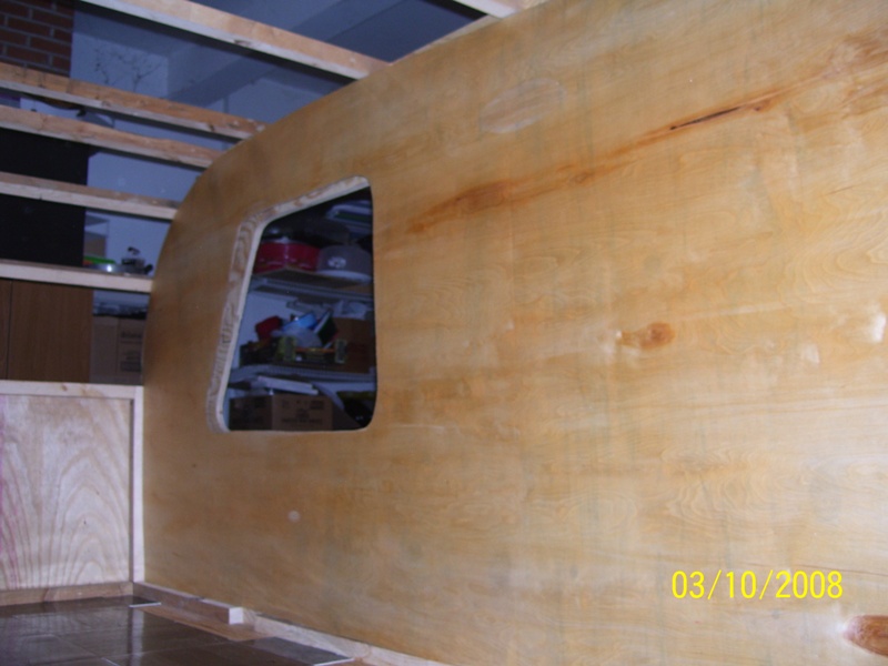

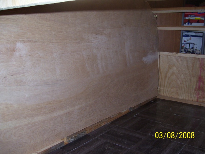

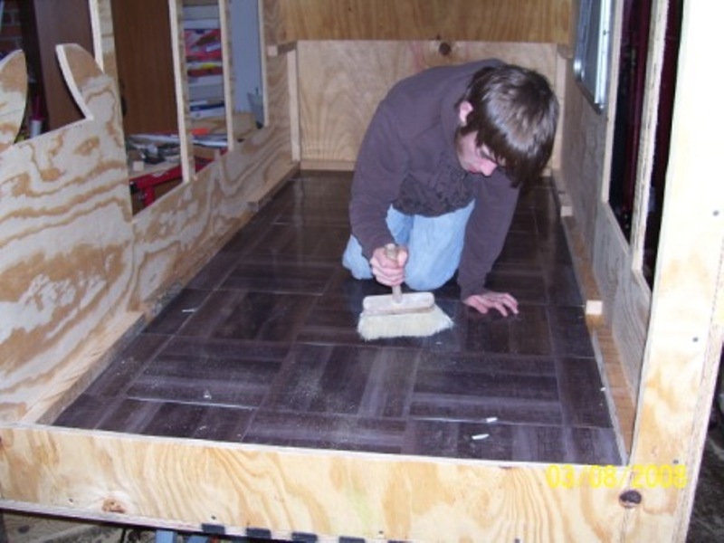

Postby Jester » Sat Mar 08, 2008 2:47 pm
Here is the progress so far today. Ready to start light sand and poly but clean up stuff forgot poly and tack cloth. Off to the store!!

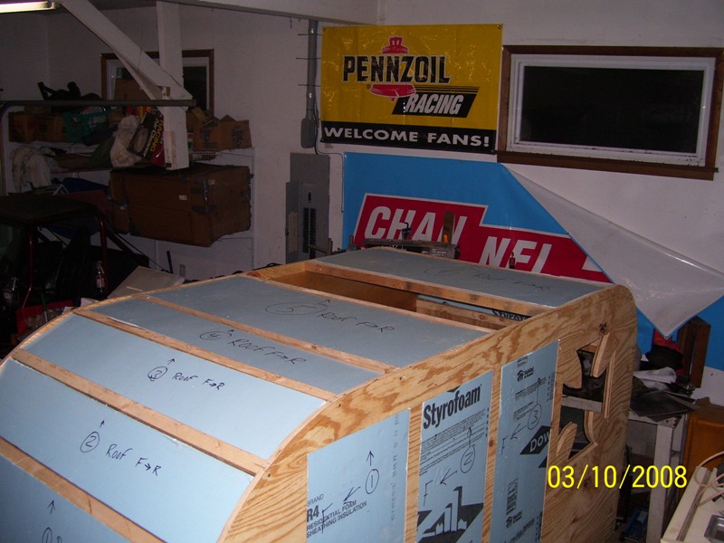

Postby Jester » Sun Mar 09, 2008 11:31 am

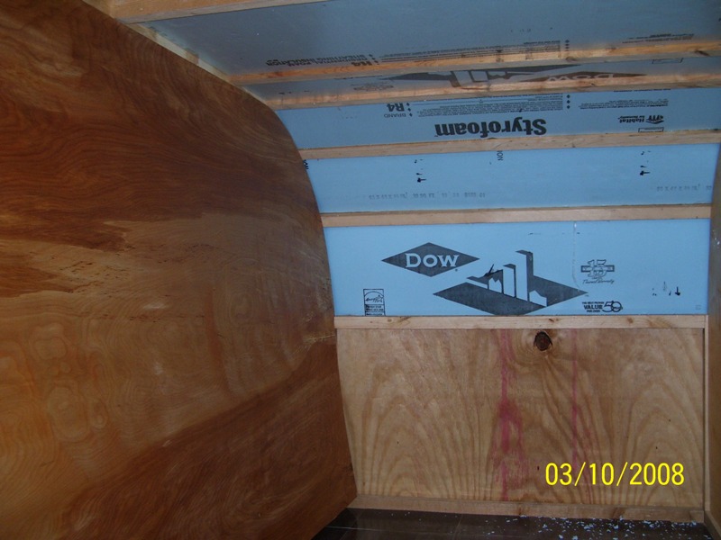

First coat of poly on. Should have spent more time sanding. Will look good though. Went to Lowes and spent another $160 in insulation, hinges. door handle, ceiling skin and rope for interior trim. :cry:
Figured out something though.....you can read for hours here and get lots of great info but until you start making mistakes none of it seems applicable to your build! :thinking:
Any suggestions about my floor tile cement to hang interior skins??
If it needs waxed OR pays to be waxed....It's gonna be trouble!!
Jester
Posts: 61
Images: 65
Joined: Sun Feb 26, 2006 10:02 pm
Location: Western PA

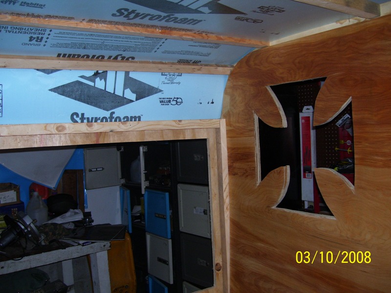

Postby Jester » Sun Mar 09, 2008 9:18 pm
Okay. big day here! Got first coat of poly on both interior skins and tried to get garage warm enough for the process. That lead to airing out the house after 3 hours of drying time. :( Wife not impressed.
new plan: Install skins first and then poly. :thinking: Nope, still too cold in garage to glue up skins.
Okay, lets think....need to get cabin area warm enough to glue and poly..IDEA!! Put in foam for roof, hang skins temporarily , put up ceiling temporarily then add small electric heater and fan for venitilation leaving garage door open keeping wife happy and family alive!! 8)
Got the foam in and skins in and was overcome....by exhaustion!! Will continue tomorrow if I recover! :)

Postby Miriam C. » Sun Mar 09, 2008 10:04 pm
It is really really hard to get glue to dry in winter. Now my opinion of glue.......tightbond or pl. 8) I think carpet glue stinks :? :lol: I tacked my side skins up with small panel tacks and will put the trim in. I wasn't able to find the wood I wanted and decided to look for it, but finish the camper.
You guys are doing a great job so keep it up. The poly looks better after a few coats.
