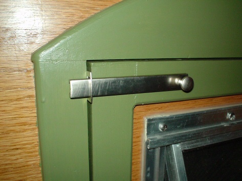

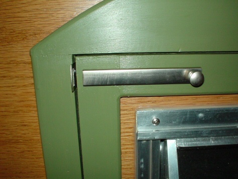

Postby b.bodemer » Mon Apr 14, 2008 2:41 pm
Ron,
I certainly know what you mean about not seeing a td before you build. And even if I had seen one I don't think I could have absored every single detail about the construction unless I was at a certain step and only needed to look at that one detail.
I was also lucky to have my buddy Bill help me on the doors. But after a few trips I got to thinking how will my door and regular door house knobs do as far as traveling and hitting lots of bumps???? I mean.........that's not the way our door knobs at home are used.
I thought I'd add a little extra protection and found in the hardware section at Home Depot this latch or bolt. There are a couple of ways to mount it. Heck it might even work for you to have one inside and out. Latch the outside while traveling and the latch the inside when occupied.
Just happy to share these two pics with you. This made me feel much better about my doors...........
Good luck,
Barb
b.bodemer
Posts: 1608
Images: 328
Location: Lakewood OH
Postby Alphacarina » Mon Apr 14, 2008 3:59 pm
Barb,
I guess (hope) that if someone was to slide that bolt closed with you inside the trailer, you could reach out through the window somehow and let yourself out?
Try it to be sure - I wouldn't wanna be in there if there was ANY possibility you could get locked in by some prankster!!
Don

Postby Mini Renegade » Mon Apr 14, 2008 4:01 pm
b.bodemer wrote:Heck it might even work for you to have one inside and out. Latch the outside while traveling and the latch the inside when occupied.
That`s OK until some prankster locks you in :lol:

Postby b.bodemer » Mon Apr 14, 2008 4:54 pm
:twisted: :twisted: :twisted:
Yep..............I could undo it through the window but I hope that person would not be hanging around when I come out the door! :lol:
Barb
