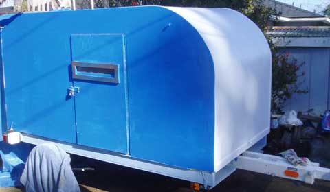

I used primer and exterier semi glossy on the sides and Glossy on the top
I get fog almost every morning (I live next to the Pacific Ocean) I use a cover alot but when I am working on it, it gets wet and seems to be doing fine. I did not sear it underneath and that might be a good addition if you can afford it but I think I will be doing just fine.
I used Bear paint from HomeDepot.
Ron D.

Postby Ron Dickey » Tue May 06, 2008 12:51 pm
P.S.
The nice thing about paint and being low on money you can get a small pint at a time for second and third coats. if you cant swing the gallon thing.
I first got a Gal. in primer and painted the intire thing. then
I got a gal for the sides and have 2 coats on it. The top I got a gallon and put 2 coats on and got a pint for the 3rd. But you could cover it in plastic and get a pint per paycheck till you are done. you can get a paint roller and pan as a set cheep. inexpensive throwaway paint brushes and if you do not care for the color most paint places have reutnred paint for cheep (you just need to look for glossy or simiglossy. you could use then for the first coats and then get pints in the color you want for the 2 last coats.
