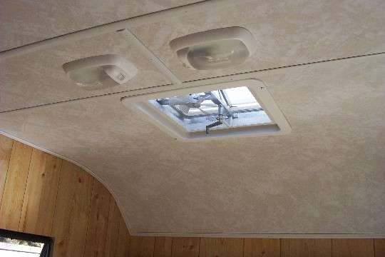

Dan, I think that is what I used that for my interior headliner and it looks great. If I recall correctly I got it on sale for about $11 a sheet. My teardrop is 5 1/2 feet wide so it was installed cross-wise.
Then I was looking for some thin ply for the top and the best stuff I could find (that wasn't Luan or cardboard) was that paneling. So I scuff sanded it and wet it and pealed off the paper pattern. It appears to be fairly decent quality. It is really strong and I soaked some pieces in water for days and days and it didn't swell or separate at all. I did pay the $14 a sheet then but it worked so well that it was worth it. I feel that with the epoxy covering it should last a while. Below is a poor-quality picture of it.
Ed
