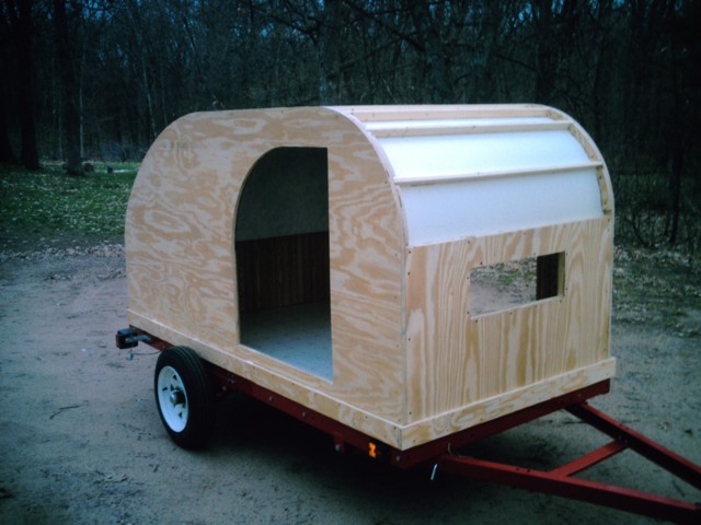

Hey Guys....you are missing a third option for mounting the sidewalls. On my build I wanted to use standard 4 foot panels for the floor, ceiling and roof to save materials and $$$. To do that the walls needed to be mount on top of the floor, flush with the edge of the floor.
I used the Generic Benroy plans for my sidewalls, but then cut a 3 1/4" strip off the bottom of each side. I glued & screwed the 3 1/4" strip to the frame of the floor and then fastened the side walls to that.
This makes a very strong joint. Plus there are no supports on the inside that will get in the way later. And the 3 1/4" piece ends up looking like a wide molding that covers the joint between the sidewall and the floor. This is an especially good way to build if you are doing a 4X8 TD...no waste and a minimum of materials to buy.
Here's what it looks like on paper:
Here's how it came together:
This shows how I finished the end result painting it the body color with a plastic molding on top of it that matches the silver trim on the TD:

I like your second option, with the side over hanging, hiding the frame, and resting on top of the floor. I think the frame being covered is better looking. This is how i hope to do it when I get started in a week or so. As I type this at 12:55am ~> severe case of TDS

We've done over 20,000 miles with our walls completely on the outside of the frame. Gives you a full 48 inches on the inside. 1" clearance is plenty of space on the HF trailer. The thing to think about is that the top will require be slightly wider than 48" which will require you to have a little waste if you're using 4X8 material.
