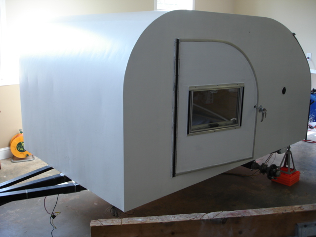

Two questions are people having problems with this that they can comment on and secondly, I'm planning a relatively big hatch (picture of ribs below) will this distort under weight with time?

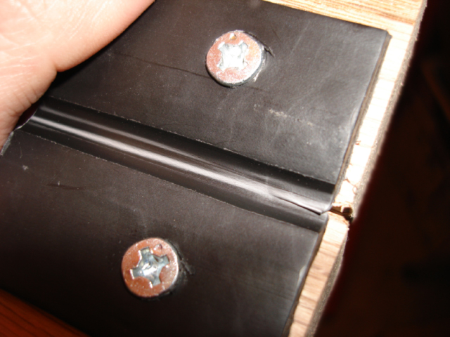

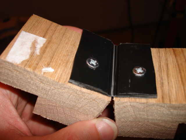

Mark Freedom wrote:Are you guys using a sealer of some kind under the plastic hinge to keep water from rolling under it?
Geron wrote:Mark Freedom wrote:Are you guys using a sealer of some kind under the plastic hinge to keep water from rolling under it?
Butyl putty tape has a proven track record. A strip of AL bar on top keeps the hinge from rippling.
G
Edited:
OOPS! 3 min apart on the posts.
I use Butyl putty 'cause I usually have to take mine apart twice![]()
You know, "The Village Idiot"
g
Wolfgang92025 wrote:There are thousands of products out there with living hinges. Your biggest enemy will the sun. If it has a UV stabilizer added, it should last several years. However, think of how many plastic product you know that live outdoors, and what they look and feel like after mother nature has had some time to work on them.
Just my opinion.
