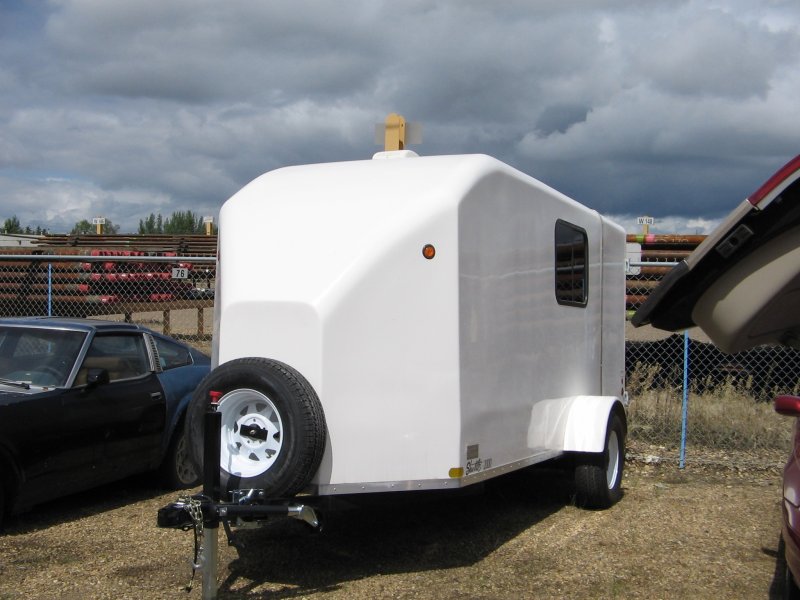

Here is a commercial version of basically what I had in mind:
http://www.golittleguy.com/cms/component/option,com_zoom/Itemid,77/catid,27/
Longer perhaps and with an additional door and windows for camping.
These do not seem to need any additional structure to maintain integrity, however I have no clue how this particular version is constructed .
How sound are your builds prior to installing your galleys?
How much structural contribution do you depend on from the addition of the cabinetry in your Galleys?

Think about a 9' version of the Modernistic/Cub with the rear profile squared off below where the galley countertop would be (I've got a pattern and could shorten & do that simple morph for you at no extra charge - www.LilBear.teardrops.net ) ... move the "galley lid hinge" forward a foot or two (how tall are your bikes at the top of the windshields?) ... and don't worry about the integrity without the galley or bulkheads, you can compensate with some simple corner bracing on either end of the galley lid hinge beam and some similar bracing at (what would be) the floor/wall juncture where the under-counter bulkhead would be. As some have already suggested, a couple of hinged bulkheads with fold-down countertops could serve as a simple food prep / galley area.
Sounds like a cool idea! Will be interesting to see what you end up building ... :thumbsup: ...!
This is exactly what I was hoping to hear. I can have some fun with this and add in a small barrel vault profile to the ceiling wall junction to add strength and visual interest.
Using strip built I can fashion most any fair curve. Sort of like a large fillet or cove molding effect... Cool! :thumbsup:
