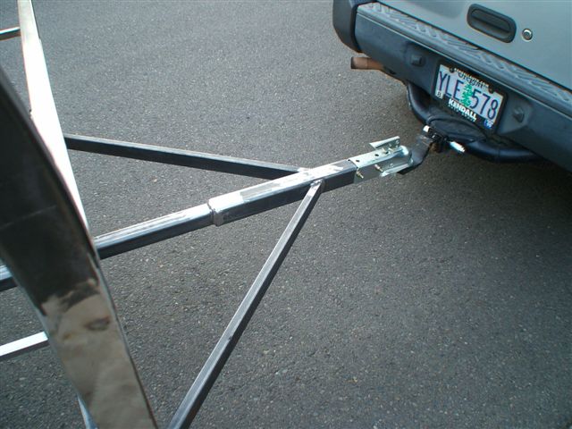

I am in the process of building "Skeletear". It has a removable/extendable tongue. My dad had the idea of doing a vertical hitch pin instead of a horizontal one, for increased security when leaving the trailer...The theiry being that somebody might have a tongue they could throw in there and tow it away, but probably not with a vertically oriented hitch pin. The other issue it would help with is that it would let me move my tongue jack further forward - hence closer to center, without it being in the way of the hitch pin.
Any thoughts? Any strong reason not to do it?
Thanks

oregonguy wrote:I am in the process of building "Skeletear". It has a removable/extendable tongue. My dad had the idea of doing a vertical hitch pin instead of a horizontal one, for increased security when leaving the trailer...The theiry being that somebody might have a tongue they could throw in there and tow it away, but probably not with a vertically oriented hitch pin. The other issue it would help with is that it would let me move my tongue jack further forward - hence closer to center, without it being in the way of the hitch pin.
Thanks
Image[/img]
I'll be posting some updated pics in my album pretty soon...
My opinion is freeing up the jack location is a good enough reason to go for it. The only down side I see is snagging something on the retaining pin from the bottom, and the pin being lost.

ya I thought about the pin snag problem too....I'm pretty sure there are locking pins out there though that would be much less likely to get knocked out.

well, in my opinion, if you drill vertically through your tongue, you'll make the steel weaker in the axis where you want the most strength.

:scratchthinking: Hmmm....you think so? It seems to me that the strength in the vertical axis would come primarily from the the vertical material - the side walls, not the top and bottom....I'm no structural engineer or anything, could be thinking about this wrong...
Anybody else want to chime in on this? I definitely don't want to significantly weaken the strength of my tongue by drilling out it's strength.

oregonguy wrote:Image[/img]
I am no engineer, but I think this tongue (I think that is 1/4" walled tubing I am seeing) will pull a 3000 lbs (or less) tear with the diminished strength just fine. Consult Andrews tongue strength guide to be sure.

I was in the steel business for a long time and you do get most of your stiffness from th side walls,if your worried about drilling a hole vertical brace it with a flat plate on the bottom side;
Most of the old farmer Brown trailers had vertical pin hitches and they pulled heavy loads.

If I'm looking at that close up photo of the damage correctly, I think that hole is actually drilled in the horizontal axis....You can see the profile of the wheel of the tongue jack in the folded position. The camera angle makes it appear that you are looking down...because of where the ground appears....but I think we are actually looking at a horizontal hole....not absolutely positive of course, but pretty sure.
My main tongue is 1/4" steel 2"x2" and the side tubes are 1/8" steel 1"x2" - should be far more than strong enough.

The most highly stressed parts of a square box beam under vertical load are certainly the top and bottom, not the sides. Holes can be drilled at mid-height through the side walls with little loss of strength... but if the design is marginal enough such a hole can still be the "last straw" leading to failure. I would certainly not drill a significant hole in the top or bottom of such a beam without adding reinforcement, such as the plate which Ron mentioned.
For an illustration of this, look at the frame rails of any modern truck: there are lots of holes through the sides, but virtually none through the top or bottom, whether the frame is a C-channel or fully boxed. Another example: look at an I-beam... the material is at the top and bottom where it is primarly needed, rather than the "web" in between which serves to keep top and bottom plates apart - and the web can be punched full of holes near the middle.
Also... is there a serious risk of someone carrying around a removable tongue to use to steal this trailer? If the trailer is that valuable and the thief that determined, they don't need a tongue at all to hook it up to a real tow truck and haul it away.

Wow, that's good info...ok...maybe I'll make a reinforcement plate on the bottom like Ron suggested, or maybe I'll just scrap the idea...The most appealing thing about it for me is the ability to move the tongue jack forward into the range I want it without the two items getting in each others way. Maybe I'll modify the hitch pin itself with a flat plate on the end or something very low profile like that so the clearance issue becomes less problematic.
It seems like having the hole towards the end of the material - where a hitch pin goes, would have a far lesser effect on strength than having a hole somewhere in the middle...?...Not to mention that inside of the female end of the tongue is a 17" long 1/4" 2"x2". doesn't that also add some stiffness and strength? It feels like I'm going overkill enough that 1 hole wouldn't be the end of the world...my target tongue weight is like 120# or so.
Regarding the theft resistance factor...sure it's not all that likely to get your trailer ripped off, removable tongue or not. This was just a side benefit that also gives one more reason to keep honest people honest. I understand that if somebody wants anything bad enough, they'll find a way to get it.

I'd say just tow that whole heap to the dump and toss it in the metal recycling bin... Save me the wheels and tires though. However, if you do decide to keep working on said heap, I (without any usable knowledge or experience on the subject) think you'll be more than fine.
To others: I've seen this tear at just about every stage of its progress, and it's so overbuilt, I see no way (short of a tree falling on the tongue) that this sucker is ever going to bend.
It's probably a good precaution to weld a plate on the bottom, but I think the vertical pin idea is as cool as the other side of the pillow. You might also want the top side of the pin to have some sort of rubber washer or grommet or something to keep excess water out of your frame.

Go with your "gut" feeling about it and let us know how it turns out. Most of the very good ideas come from people who were willing to "risk it" and it worked for them. You can make anything break if you apply enough force - compression, teinsal strength, formulas, etc are good, but drill the hole and see where it takes you

re veritcal hitch pin. The majority of strength comes from the top and bottom in most members. Think of an I beam.... I try to avoid drilling any holes in the top or bottom of any metal member on my trailers. That is where the problem might occur.
And if I do drill holes top/bottom, I try to keep them as small as possible. I would be reluctant to drill a hole that removes more than 20 pct of the surface.
